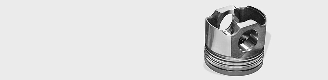

The Machining of Pistons
The machining of pistons is one of the most demanding processes in manufacturing engines and EMAG offers the whole process chain for their complete-machining. The outer contour, in particular, calls for very tight tolerances.
Demands are also increasing for production flexibility. For instance, the machine tool used to machine the external surface of the piston must be capable of handling a number of piston variants, not only referring to size and design, but the machines must be able to process aluminum, steel and hardened steel.
