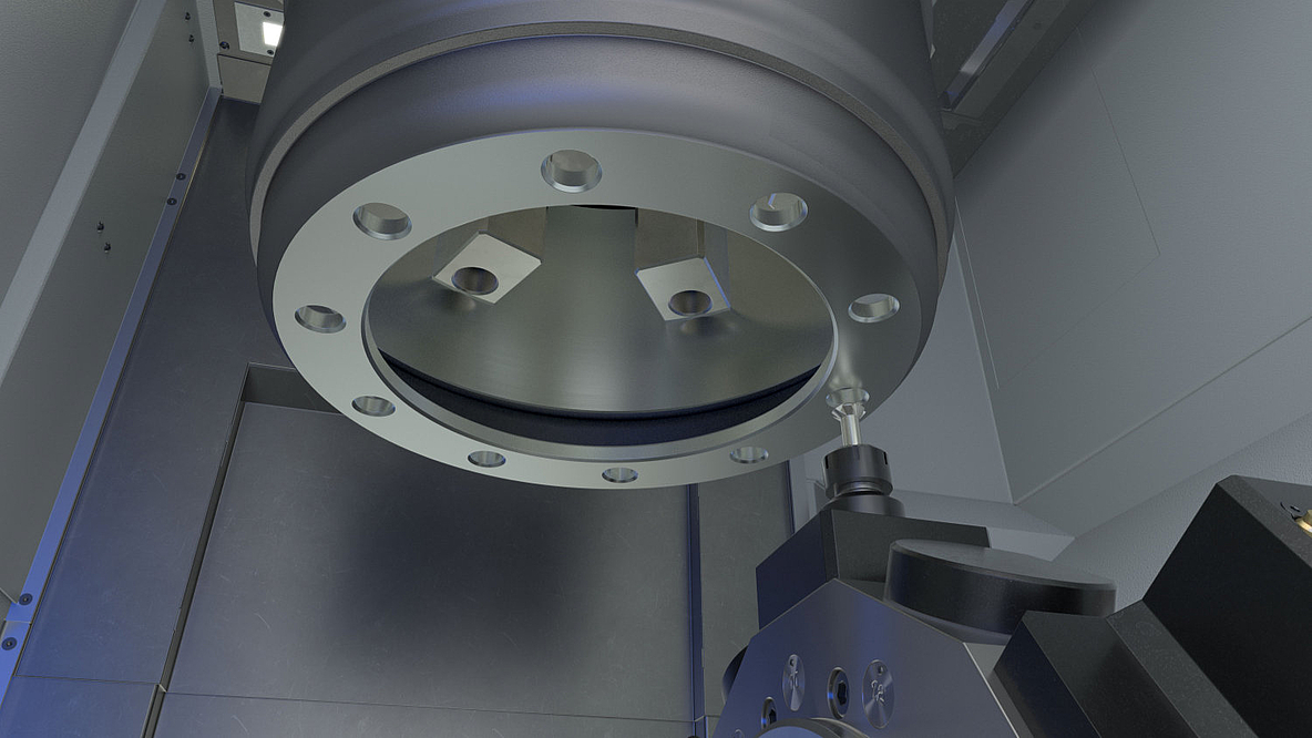

OP 20 I 1 x VL 8 – Soft turning
After the component has been turned around, the bolt ring is machined and the screw holes are drilled. The driven tool turret makes this possible.
