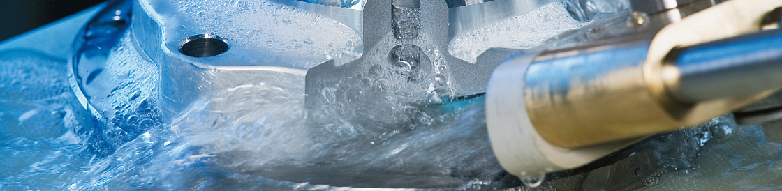

Contactless deburring with ECM - electro-chemical machining
It is fair to describe the precision deburring or burnishing of metal components using the electro-chemical machining (ECM) process as economically highly viable. As cycle times and output rates can be scaled using different degrees of parallelisation - i.e. staggering the number of workpieces machined in one clamping fixture - cycle times can be reduced to under 10 seconds. Wear-resistant, precise, contactless and economical are all predicates that apply to the ECM deburring process.
ECM deburring of a pump housing for common-rail systems
One example of a demanding deburring task is to be found in the manufacture of pump housings for common-rail systems. The mechanical machining and deburring of pump housings is currently considered state-of-the-art.
However, a precondition is that the whole process is mastered. In the case of the EMAG Group, machining, automation and deburring are all covered by their firmly established technologies. With regard to the deburring process this is of great importance, as the relatively small problem of a burr can very quickly escalate to a crisis. To prevent this, it is important to define the machining direction right from the start, when choosing the operating process and the process sequence.
Only then will it be possible to remove burrs economically and with precision. Using the electro-chemical deburring process instead of conventional deburring methods (mechanical or water jet deburring) has reduced costs quite significantly and made it possible to match the cycle time to the start-up and production phase by scaling the electro-chemical deburring process to suit the desired output rate.
