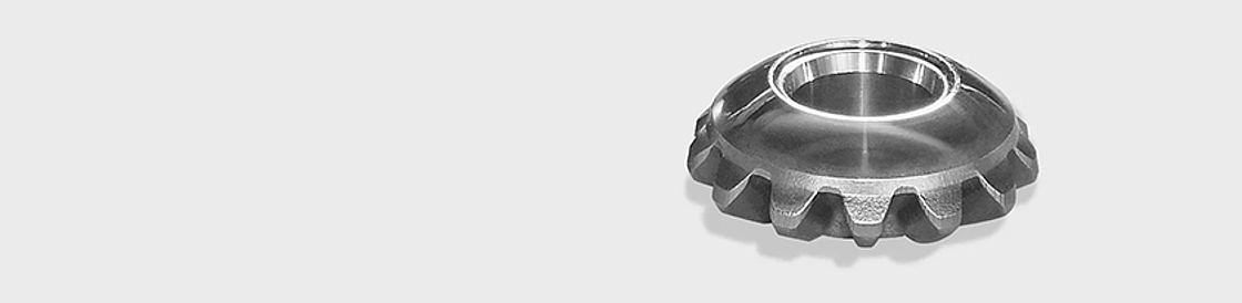

As a key element in differentials, bevel gears are mass-produced for passenger car manufacturing—many supply companies produce these components by the million every year. Bevel gear production starts with a forging process that gives the component its typical bevel gear teeth.
The subsequent turning operation differs from one manufacturer to another. In some cases, it starts with soft machining of taper faces, offsets, and end faces. After hardening comes the finish turning operation. Alternatively, the bevel gear may be hardened directly after forging, in which case it will only be turned once.
