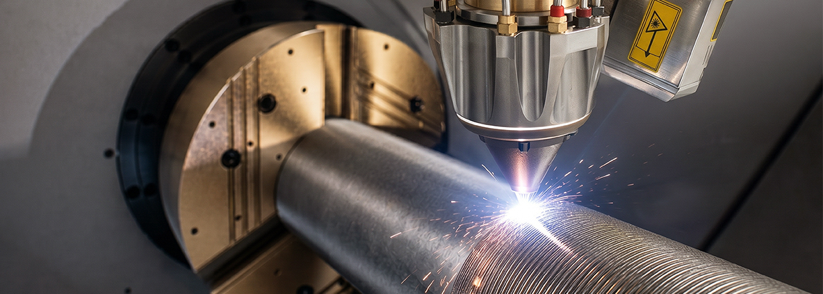

In laser cladding, metallic filler material in powder or wire form is precisely introduced into a molten pool created by the laser. This results in a metallurgically bonded layer that is firmly bonded to the base material. The process is suitable for building up wear and corrosion protection layers,repairing stressed component areas, and targeted functional modification of surfaces.
Laser Cladding for Precision Layer Deposition and Targeted Component Functionality
A key technical advantage of laser cladding is the localized heat input. This reduces thermal stress on the component, keeps distortion under control, and minimizes microstructural changes in the heat-affected zone. At the same time, layer thicknesses, mixing, and deposition geometry can be reliably controlled.
The quality of the result depends largely on the precise coordination of laser power, feed rate, filler material supply, shielding gas flow, and path movement. In automated EMAG systems, the cladding process is precisely guided via CNC axes or robot-assisted motion systems. This allows for machining of both rotationally symmetric components such as shafts, cylinders, or bearing seats, as well as complex, contour-dependent surfaces with defined path guidance and consistent layer quality. The exact coordination of relative motion, material feed, and energy input ensures reproducible results across the entire component.
Laser cladding is thus a technically sophisticated manufacturing process for applications that require defined coating properties, high adhesion, and targeted material application.

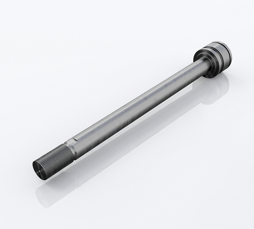

Laser metal deposition of hydraulic cylinders
Hydraulic cylinders, and in particular their piston rods, are exposed to moisture, dirt, pressure spikes, and mechanical wear. During laser metal deposition, a metallurgically bonded protective layer is selectively applied to the stressed surface. This increases resistance to wear and corrosion and extends the service life of the component.

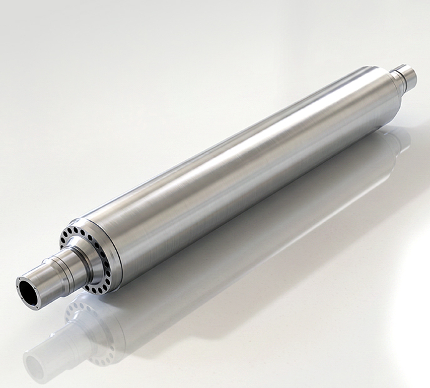

Laser metal deposition of rollers
In laser metal deposition of rollers, a dense, metallurgically bonded functional layer is precisely applied to the rotating surface. The process is suitable for press, printing, and calender rollers, as it makes wear, corrosion, and thermal stresses manageable. At the same time, dimensional accuracy is maintained even on long rollers.

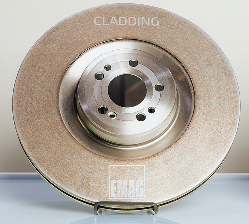

Hard coating of brake discs
When performing hard coating of brake discs, the friction surface is precisely treated with a wear-resistant functional layer using a laser. This reduces brake dust emissions, increases service life, and enables pore- and crack-free layers with defined geometry. Depending on requirements, single- or two-layer systems are used.

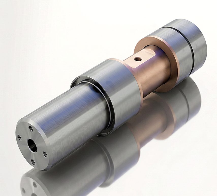

Coating of plain bearings for wind turbines
When coating plain bearings for wind turbines, main shafts and planetary pins are selectively laser-coated with soft plain bearing materials. This creates bond-type coatings with good emergency running properties, high wear resistance, and low material consumption. The process is particularly suitable for highly loaded components in continuous operation.
