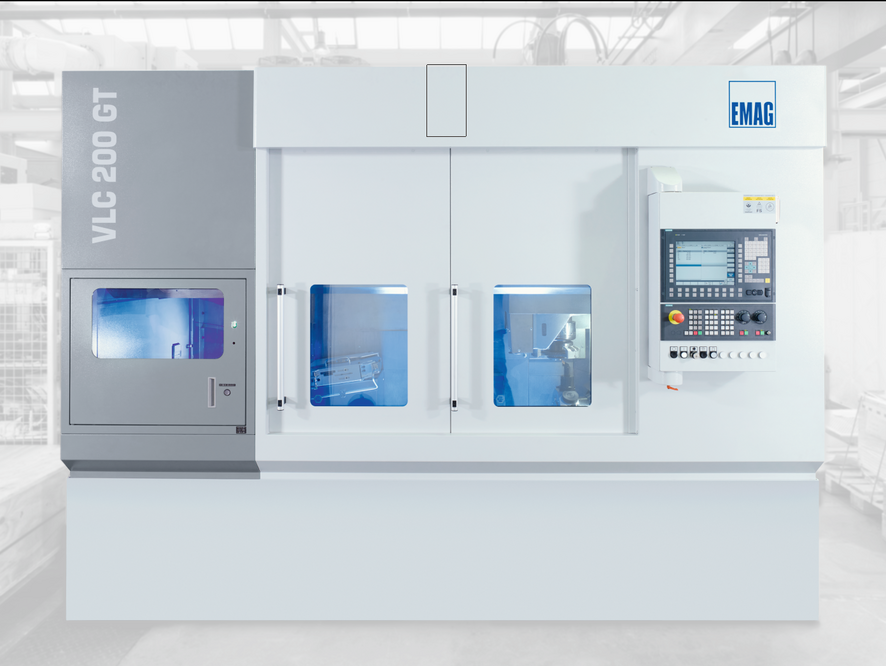

By combining hard turning and grinding methods, CVT pulleys can be machined in a single clamping operation with the VLC 200 GT.

To be able to machine CVT pulleys, in addition to the tool turret, the VLC 200 GT was equipped with an external grinding spindle, whose performance was specifically tailored to the workpiece as was the grinding wheel configuration.  Combining these methods—all other surfaces and bore holes of the component can be turned—provides the benefit of decreasing tool costs and cycle times. The grinding wheel wears down more slowly and therefore does not need to be dressed as often and the use of twin tools on the high-capacity tool turret enables a nearly undisrupted production cycle.

Manufacturing systems for hard machining of pulleys for CVT transmissions
The machining of CVT pulleys can be broken down into three main operations:
  1. The component is first checked, labeled with a matrix code and then measured.
  2. Hard machining is then performed on a total of four VLC 200 GT machines. Among other operations, the inside and outside diameters, as well as the curvature of the component, undergo various turning and grinding processes.
  3. Additional grinding processes, including “super finishing,” are followed by washing and final surface inspection.
