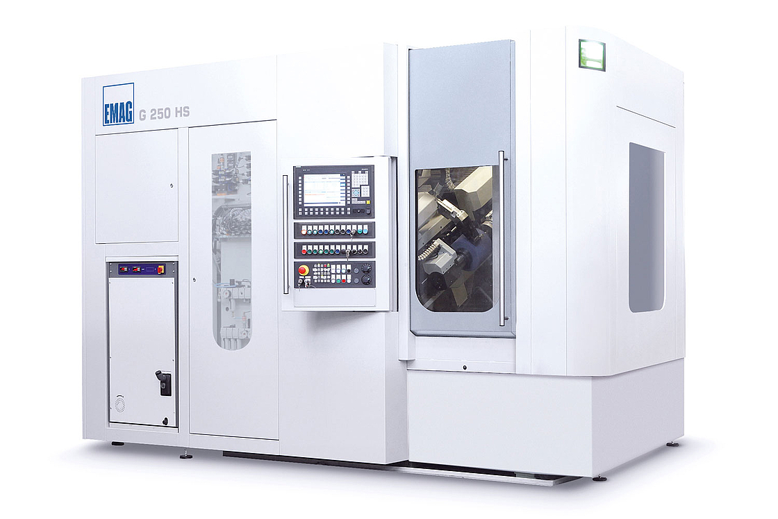

G 250 HS gear grinding machine - highest productivity level for workpieces with interfering contours
The G 250 HS from EMAG SU is a gear profile grinding machine that has been specially developed for the production of gears and shafts with interfering contours. Thanks to the high-speed grinding head and the high-productivity use of smaller grinding wheels, workpieces with complex geometries and grinding positions that are difficult to access due to interfering contours can be machined with precision and efficiency. With its compact design and high degree of flexibility, the G 250 HS is the ideal solution for highly complex production tasks, such as those frequently encountered in the geared motor sector.
Innovative technology for precision gear production
With its highly rigid cast iron bed construction, the G 250 HS guarantees stability and precision. Conversion from generating grinding to profile grinding is possible in just a few minutes, as both processes take place on the main spindle, thus increasing flexibility in production. Generating grinding is carried out with ceramic dressable grinding wheels, while electroplated CBN, dressable CBN or dressable ceramic wheels are used for profile grinding. Due to the high motor speeds on the grinding head, even very small profile grinding wheels can be used economically.
The machine machines gears and shafts with small ceramic or CBN grinding wheels and offers efficient production solutions for demanding requirements thanks to its excellent accessibility and short set-up times. The G 250 HS is suitable for both small and large series production and is very easy to integrate into manufacturing systems.
