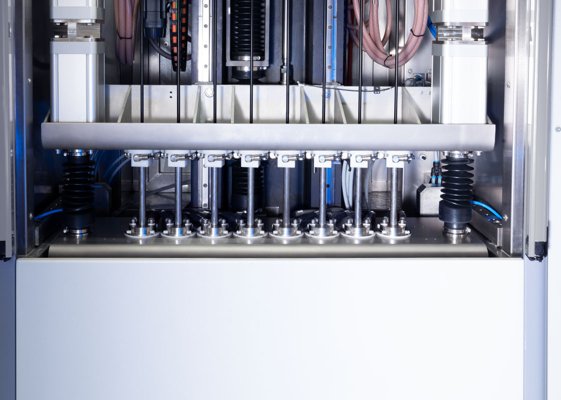

Cathode during rifling of a gun barrel with the PO 3000 IP ECM machine
Illustration of the electrochemical rifling process in the PO 3000 IP: The guided cathode generates precise tension-field profiles in the gun barrel.
