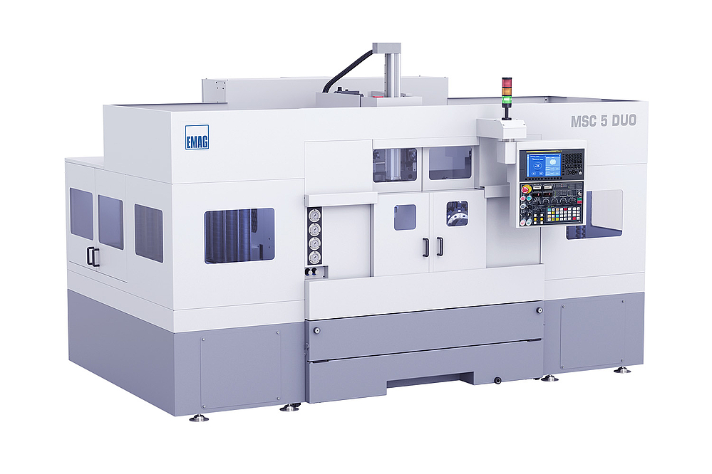

MSC 5 DUO: Front-loading CNC lathe for maximum productivity
The MSC 5 DUO is a twin-spindle CNC lathe engineered for high-performance batch production. With its innovative split-bed design, powerful spindles and fully integrated 3-axis gantry loader, this machine delivers exceptional precision, reliability and efficiency. Whether in automotive, hydraulics, pneumatics or medical component production, the MSC 5 DUO ensures faster cycle times, reduced downtime and superior machining results.

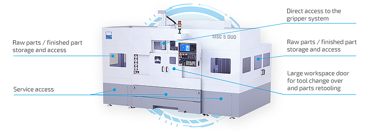

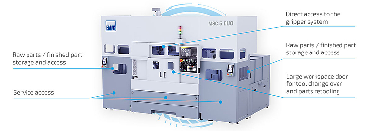

Simple servicing for minimal downtime
When designing the MSC 5 DUO lathe, special emphasis was placed on easy servicing:
  1. Easily accessible service components for quick maintenance
  2. Ergonomic tool change from the front
  3. Clear fault diagnosis of the control unit for fast troubleshooting
  4. Direct access to the workpiece gripper system
  5. Large work area door for changing tools and retooling components
These well-thought-out details reduce downtimes for maintenance work to a minimum and contribute to the high availability of the machine.
MSC 5 DUO lathe with large front opening for easy tool changes, optimum access to chucks and strategically arranged maintenance points that significantly reduce set-up and maintenance times.
Sophisticated accessibility concept of the MSC 5 DUO with large work area doors and ergonomically positioned maintenance points for minimum downtimes.
