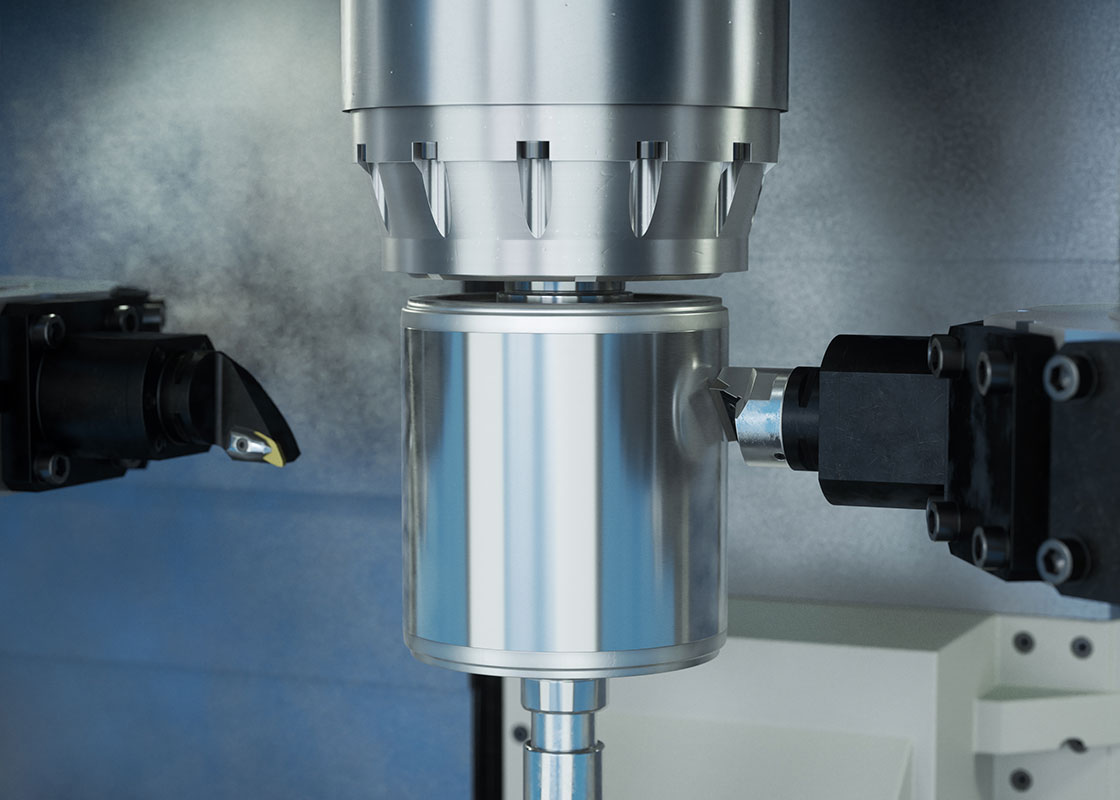

The VTC 200 turning center is the customized version of the modular VT 4 machine. Its multifaceted configuration options make it possible to cover a wide range of applications. The vertical turning center creates diverse possibilities for users to optimize shaft production.
VTC 200 Turning Center for Flexible and Productive Shaft Manufacturing
The VTC 200 vertical turning center is designed for the most productive manufacturing of shafts with a length of up to 630 mm and a diameter up to 200 mm. The turning center has two tool turrets, each with 11 tool positions for machining shafts (with the 12th position occupied by the tool gripper). This enables the four-axis machining of workpieces simultaneously from two sides, leading to a significant reduction in cycle times.
The integrated pick-up automation uses the turning center's tool grippers to optimize non-productive times. While one spindle unloads the finished part from the machining area onto the integrated conveyor belt, the other work spindle takes the next raw part from the parts storage section on the other side of the turning center and transports it to the machining position.
