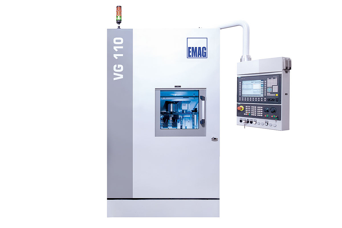

Vertical grinder VG 110 for the high-speed machining of small workpieces
This vertical face grinder is a true all-rounder when it comes to precision machining (i.e. face grinding and internal grinding) of small chuck parts. Thanks to the modular VG 110 face grinders series, the user can select either a “traditional” grinding process or can take advantage of the multiple functions which allow a combination of turning and grinding in a single machine.
The main application for the internal grinders is the economical machining of small workpieces of between 2 and 60 mm in diameter in large batches.
Face grinding and internal grinding or combination of turning and grinding in a single machine
The traditional grinding processes, i.e. internal grinding, face grinding, external circular grinding and non-circular grinding, are used along with a combined machining process involving hard turning and grinding. Here, all sections which can be manufactured by fail-safe turning processes are hard or soft finish-turned and then finish-ground (i.e. face grinding) in the same workpiece clamping. This mainly occurs after the pre-turning operation if it is required depending on the quality level that is to be achieved. This guarantees higher workpiece quality while reducing cycle times. In addition, the wear of grinding tools is reduced and thus the tools have to be dressed less often.
The face grinder VG 110 stands for short travel lengths, high speeds, outstanding rigidity and integrated cooling system, short idle times, high productivity and precision. The X- and Z-axes are separate to achieve maximum accuracy when machining small workpieces. The vertical Z-axis is equipped with a linear drive unit. This allows the grinding spindles to make short, quick oscillating strokes. The X-axis determines the accuracy and is completely removed from the machining area in the vertical arrangement of the internal grinder. The high-resolution measuring system is positioned 100 mm from the machining area creating perfect conditions for extremely high accuracy.
The VG 110 face grinder is characterized by its extremely compact design with no additional units. The energy container and the fluid and electrical components are mounted on the back. The VG 110 face grinder stands out thanks to its accessibility and the ease with which tooling can be carried out.
The VG 110 offers all modern grinding technologies:
  • Grinding tools - e.g. ceramic or galvanized CBN grinding wheels
  • Sensor technology - adaptive grinding, initial cut detection, touch dressing
  • Dressing technology - dressing spindle for use of diamond form rolls
Thanks to the modular machine concept of the face grinders, the tool equipment can be adapted to suit the required machining task. The following variants are available:
  • One or two internal grinding spindles for circular or non-circular grinding
  • One internal or external grinding
Advantages VG 110
  • High vibration dampening and therefore long tool service lives and high surface quality
  • Complete machining in a single clamping operation
  • Chips fall downwards
  • Short chip-to-chip times
  • Very high precision
  • Small footprint
  • Optimum accessibility, quick machine set-up
  • Ease of operation
  • Operation of multiple machines taking up minimum floor space
  • Short travel lengths
  • High speeds
  • High rigidity
