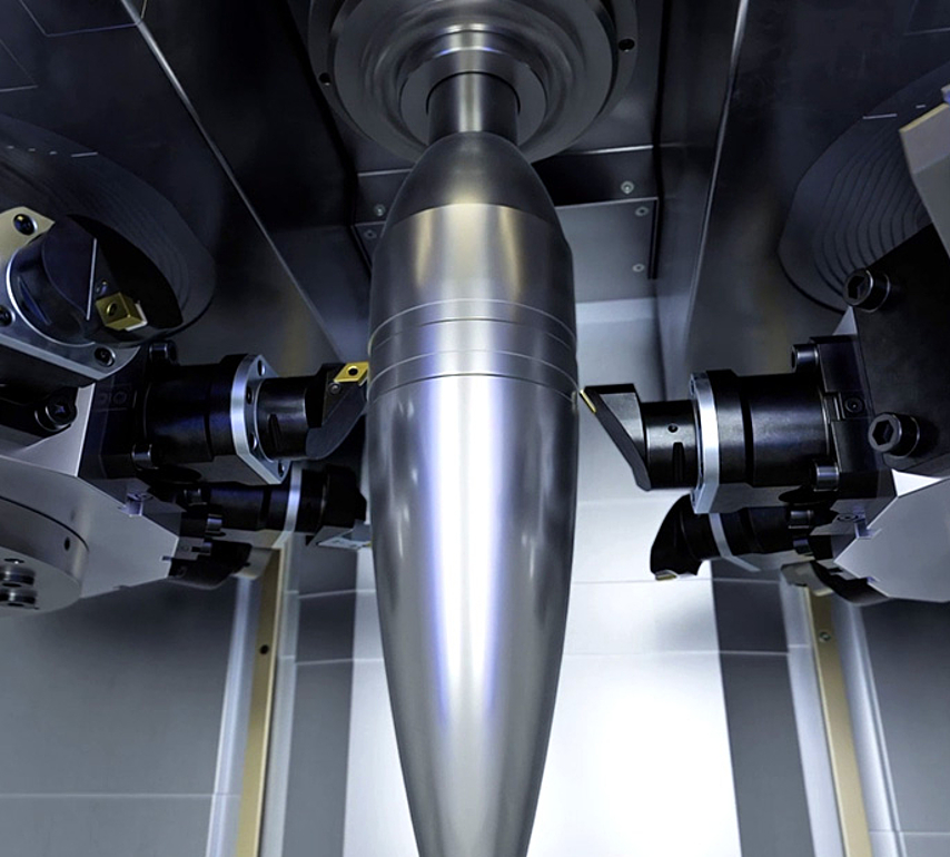

4-axis machining of a 120 mm shell on the EMAG VT 4: Vertical lathe for stable, precise, and efficient machining.
The VT 4 enables precise 4-axis turning of the 120 mm shell – for high machining performance and optimum dimensional accuracy.
OP 10: Machining on the VT 4
Workpiece: Shell, 120 mm caliber
Machine: EMAG VT 4
Technology: Vertical turning
  1. Stable machine design for high machining performance.
  2. Vertical clamping prevents vibrations and reduces chip problems.
  3. Ideal for initial clamping for precise machining of shells.

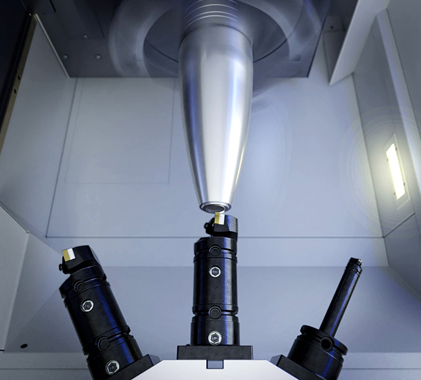

120 mm shell being machined on the EMAG VL 8: Pick-up turning machine for precise, automated finishing in the second clamping.
The VL 8 takes over the second clamping of the 120 mm shell. With a pick-up spindle and high process stability, it ensures precise finishing.
OP 20: Machining on the VL 8
Machine: EMAG VL 8
Technology: Vertical pick-up turning
  1. Automatic loading and unloading via pick-up spindle.
  2. High dimensional accuracy and shape accuracy in series production.
  3. Perfect for the second clamping for finishing the shell.
