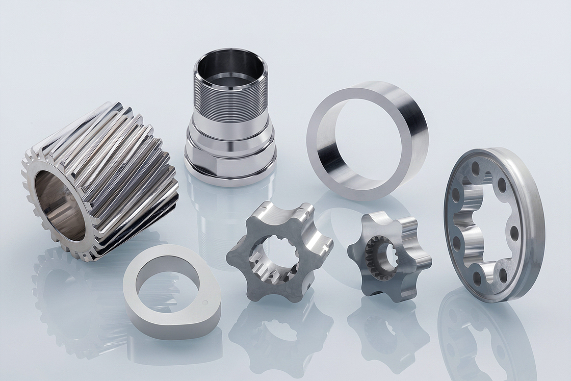

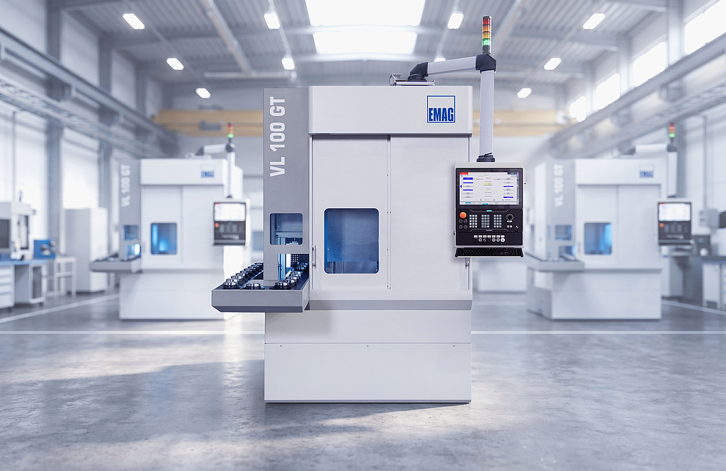

Gear wheels, planetary gears, sprockets, pump rings, individual cams, and wave generators: These chucked components are produced in the millions for medium- and large-volume production. After hardening, each workpiece undergoes precision machining, where dimensional accuracy, surface finish, and positional tolerances must simultaneously be maintained. With the VL 100 GT, EMAG offers a vertical turning and grinding center that combines hard turning, internal grinding, and external grinding for workpieces with a diameter of up to 100 mm in a single setup – with a footprint of approximately 9.6 square meters.

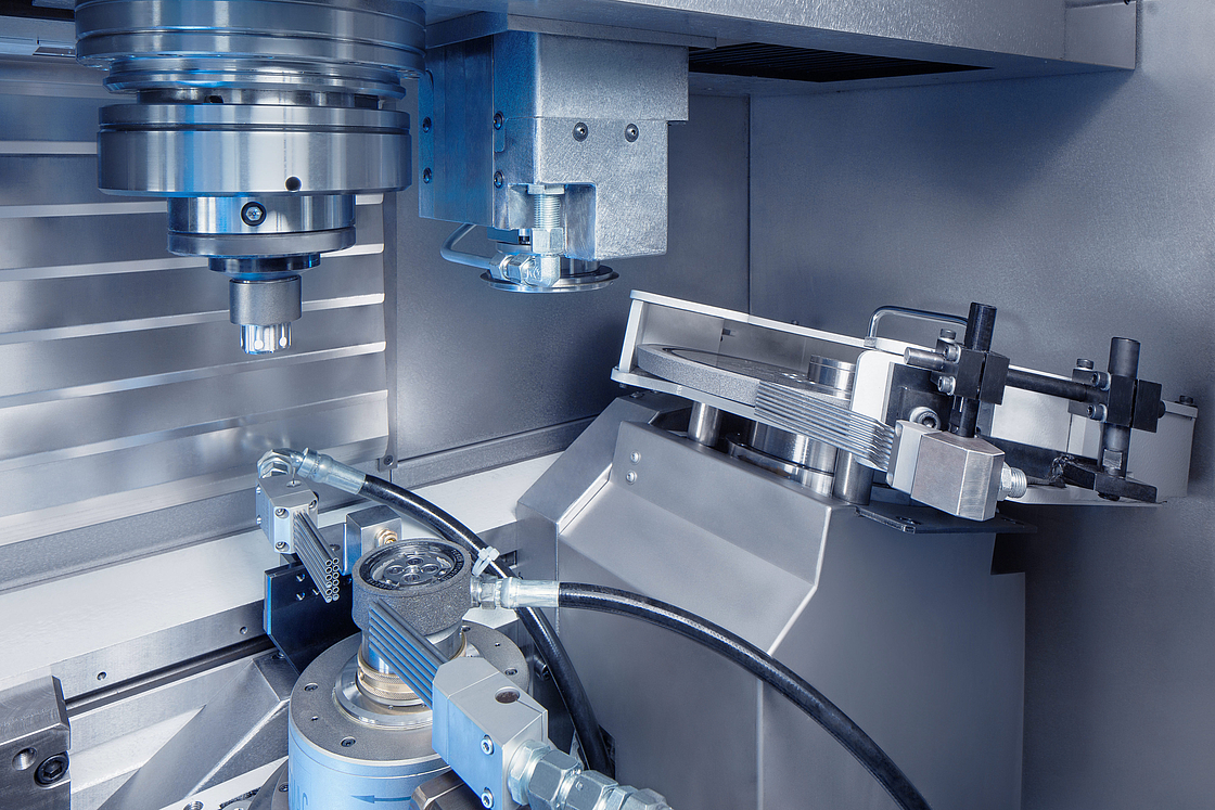

The VL 100 GT operates with the vertical machining principle: The workpiece spindle is positioned above the work area and picks up the workpieces from the integrated conveyor belt using a pick-up process. Chips and grinding slurry fall freely downward by gravity without accumulating on the workpiece or the guideways. This reduces thermal interference, prevents surface damage, and minimizes cleaning requirements. User-friendliness is also a top priority with the VL 100 GT: The ergonomically designed work area enables short setup times, and the compact footprint allows for the operation of multiple machines.
The machine base is made of MINERALIT® polymer concrete, offering eight times greater vibration damping than conventional cast iron. In fine machining, where surface roughness values in the range of Rz < 1.2 µm are required, this damping is a critical factor in achieving quality. The resulting surfaces are free of distortion and meet the requirements for highly stressed functional surfaces in gearboxes.

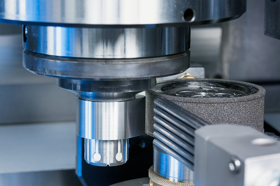

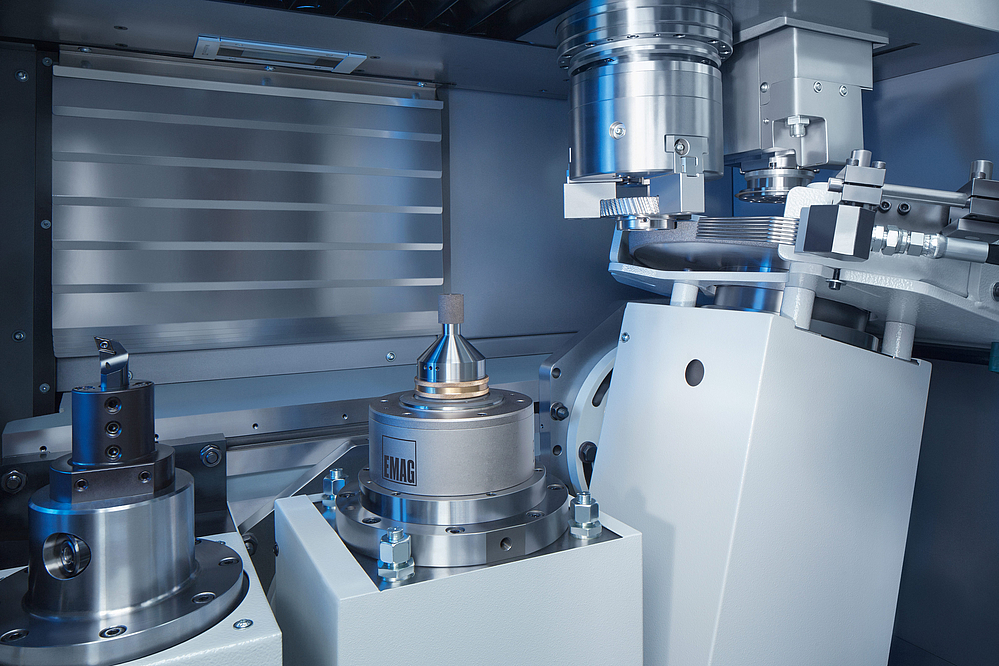

The work area is tailored to the specific workpiece range in consultation with the customer. Available options include internal grinding spindles for bores (corundum or CBN), external grinding spindles for cylindrical surfaces, flat shoulders, and contours, as well as one or two solid steel holders for hard turning operations. This results in configurations ranging from pure internal grinding to a combination of turning and grinding, all the way to complete-machining with turning, internal grinding, and external grinding in a single setup.

The combination of hard turning and grinding in a single setup is a key advantage of the VL 100 GT. In the first step, end faces, chamfers, and flutes are produced by hard turning. These operations are completed much faster by turning than by grinding. Subsequently, the high-precision geometric features – such as bores, O/D (Outer Diameter), and running surfaces – are finished by grinding in the same setup. The hard pre-turning leaves only a few micrometers of stock for the grinding process. This approach significantly shortens the total machining time and eliminates reclamping errors, ensuring the positional relationships between machined surfaces with the highest accuracy. The low material removal during grinding reduces wheel wear, extends dressing intervals, and lowers tooling costs. At the same time, the volume of grinding slurry decreases, which minimizes disposal costs and simplifies the treatment of cooling lubricants. Dry machining is possible in certain configurations.

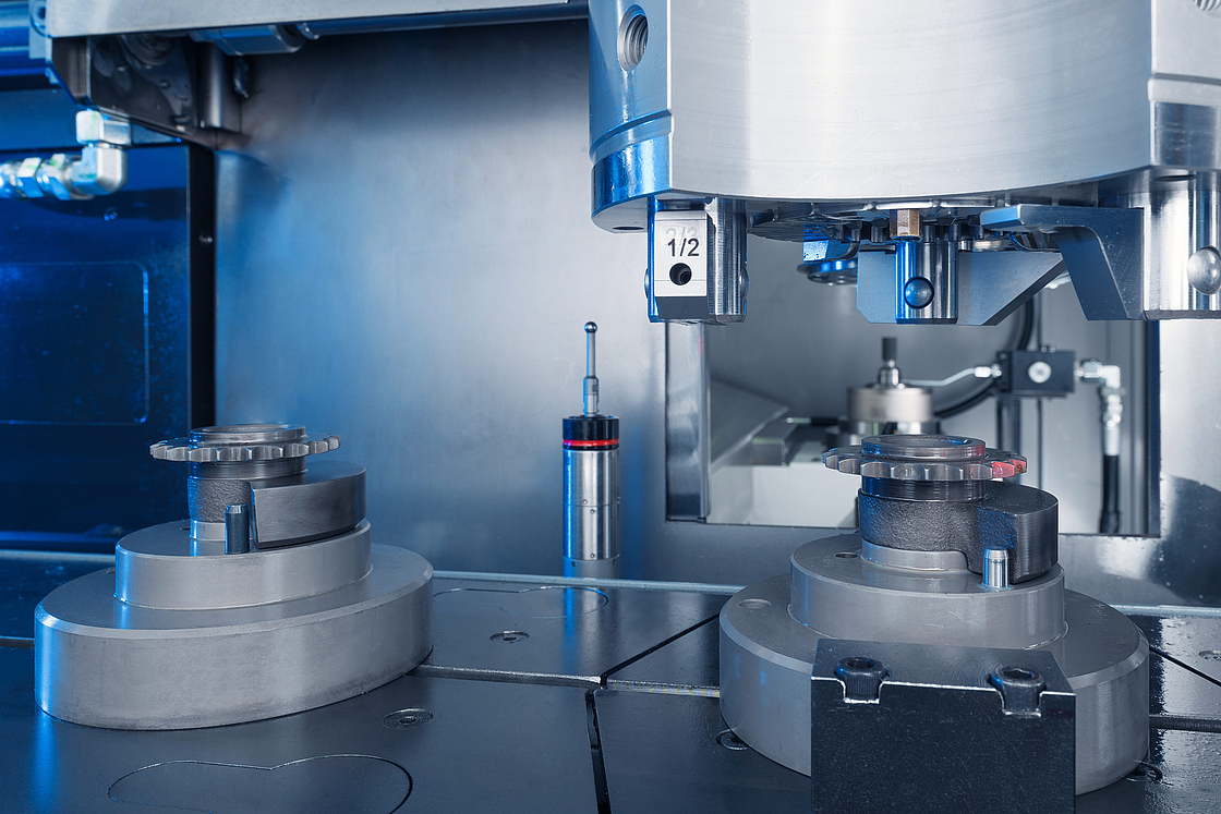

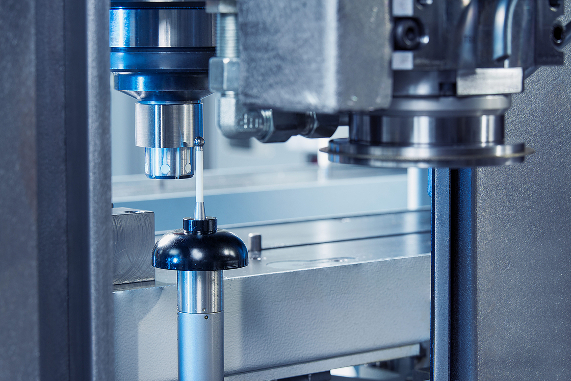

A structure-borne sound system enables contact detection between the grinding wheel and the workpiece, as well as between the dressing roller and the grinding wheel. Adaptive process control monitors the grinding process in real time and adjusts the feed rate to the current machining conditions. Touch dressing is possible. The measuring probe, positioned between the work area and the pick-up station, is protected from contamination. Since the workpiece remains in the setup, measurements can be taken before, after, and between individual machining steps.

A specific application demonstrates the machine’s capabilities: After automatic loading, the bore is finished with a CBN grinding wheel. Subsequently, two block-type tool holders perform machining of the end faces via hard turning. Finally, the integrated measuring probe checks the quality. The entire process takes less than 35 seconds, of which about 10 seconds are spent on workpiece changeover, 15 seconds on hard turning, and 10 seconds on grinding.
