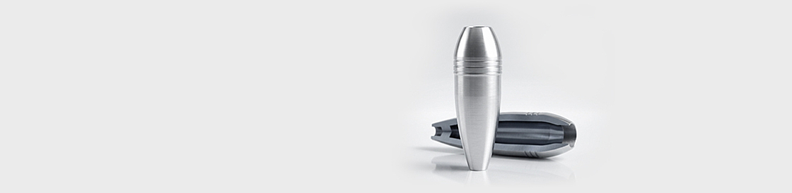

Precise shell processing for 120 mm mortar ammunition
Precision is no coincidence – it is the result of a carefully designed manufacturing process. In producing 120 mm mortar ammunition, the machining of the shell is critcal to ensuring the projectile functions safely and accurately in use. At the same time, cost-effective mass production demands a stable, compact, and automated process.
