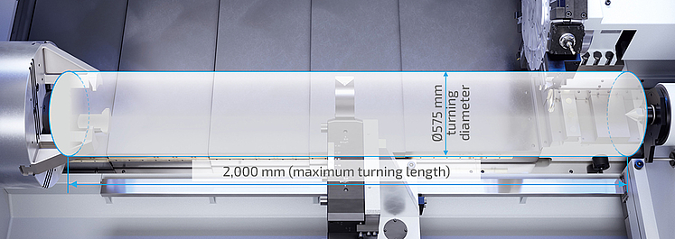

USC 850 - The precise and powerful universal lathe for large turned parts
The USC 850 is a state-of-the-art universal lathe that has been specially developed for the precision and efficient machining of large turned parts. With its robust design, state-of-the-art control technology and excellent machining accuracy, it is ideal for use in the supplier industry, aviation and general mechanical engineering.
With a maximum turning diameter of 700 mm and a turning length of 2,000 mm, this machine offers exceptional machining flexibility. It is capable of safely clamping and machining workpieces weighing up to 600 kg with a tailstock. Thanks to the IT6 machining accuracy, the USC 850 enables high-precision machining that meets even the highest requirements for dimensional accuracy and surface quality.

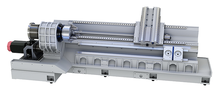

Stable machine base body as the basis for high-performance machining
An outstanding feature of this universal lathe is its stable machine structure. The machine base is designed in a 60° inclined bed construction, which not only guarantees exceptionally high static and dynamic rigidity, but also ensures optimum vibration damping. By using high-quality, double stress-relieved cast iron, the machine minimizes deformation-related production deviations and ensures consistent machining results over the long term. This design is complemented by hardened flat guides with generous contact surfaces, which enable precision and low-wear movement of the axes.
Machine design of the USC 850 universal lathe with 60° inclined bed construction made of cast iron for optimum stability and vibration damping.
The USC 850 is equipped with a solid 60° inclined bed which, in combination with high-quality cast iron, offers exceptional static and dynamic rigidity. This design ensures minimized vibrations and consistent manufacturing accuracy.
