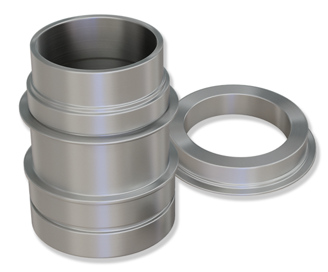

From Traditional Gears to Chucked Components with Internal Taper
The VLC 350 GT allows for the traditional hard machining of gears, from hard turning of end faces and pre-turning of the boreholes and outer synchronizing taper, through to finish grinding of those contours. The VLC 350 GT can also machine other chucked components with internal tapers. For components with internal tapers, the internal grinding spindle with NC swiveling axis pays off:
1. End Face Turning:
Loading (and subsequent unloading) is performed at high speeds with a pick-up spindle. The machining operation starts with hard turning of the end faces.
2. Contour Turning:
Depending on the component geometry, inner contours (with one or two tapers), a cylindrical borehole, and the outer synchronizing taper can be pre-turned in the second step.
3. Grinding the Internal Contours:
The use of a cylindrical grinding element on the swiveling NC axis makes it possible to machine various internal taper angles. To do this, the grinding spindle is swivels precisely to the required angle for the specific case. Any required boreholes are also completed this way (with a zero-degree grinding angle).
4. Grinding the Outer Contours:
The final step is the grinding of the outer synchronizing taper with the external grinding spindle.
