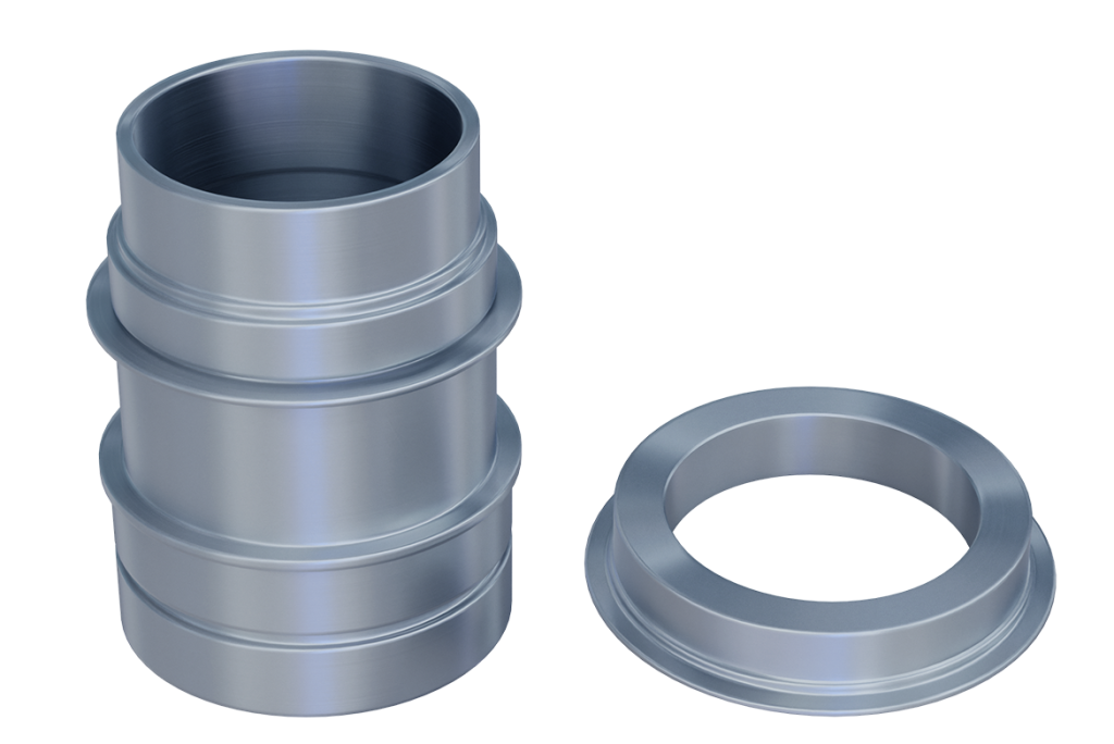

Two wave generators for strain wave gears with elliptical contour.
Precision component of a strain wave gearbox. The wave generator transmits the elliptical motion to the flexspline and requires µm-precise machining.

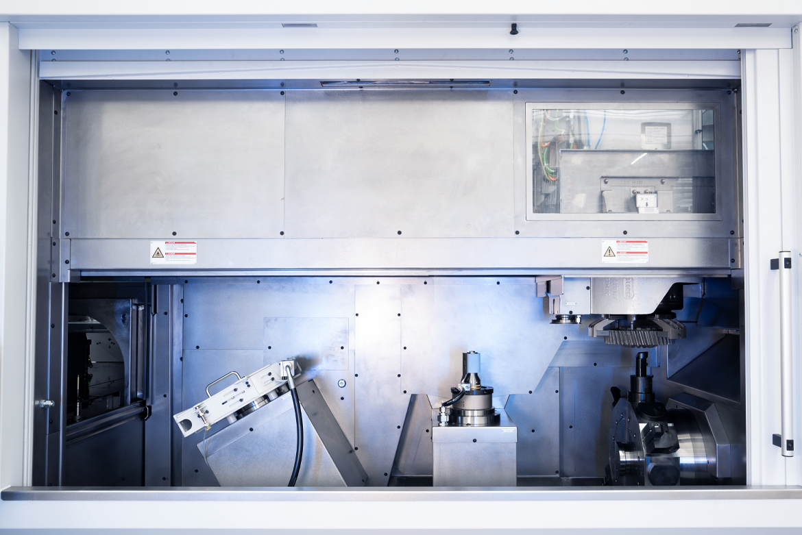

Work area of the VLC 350 GT with grinding spindle and turret for combined turning, milling and grinding operations.
View into the work area of the VLC 350 GT. The machine combines turning, milling and grinding in a single setup and guarantees maximum shape and dimensional accuracy for complex workpieces.

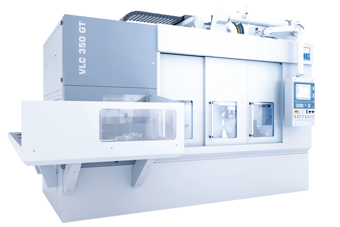

The VLC 350 GT is designed as a vertical turning and grinding machine with the following configuration:
Technical Equipment:
  • Vertically arranged main spindle (workpiece spindle): Ø400 mm chuck, swivel diameter 420 mm
  • Turret with integrated turning tools and driven tools
  • Internal grinding spindle (B-axis): Speed range 26,000-75,000 min-¹
  • External grinding spindle: grinding wheel Ø400 mm, 7,200 min-¹
  • Dressing spindle for automatic grinding wheel conditioning
  • X-axis with linear motor: 2,390 mm stroke, rapid traverse speed 120 m/min
  • Z-axis: 350 mm stroke, rapid traverse speed 30 m/min

The linear direct drive in the X-axis enables highly dynamic positioning movements without mechanical backlash. This is crucial for elliptical machining, as the continuous interpolation movement requires high accelerations and changes of direction. Due to the backlash, conventional ball screws exhibit path deviations that are unacceptable with the required tolerances.
VLC 350 GT - vertical multifunctional machine for combined turning, milling and grinding in a single setup.
The VLC 350 GT combines turning, milling and grinding in one machine. Its vertical pick-up concept enables complete-machining in a single setup with maximum precision.
