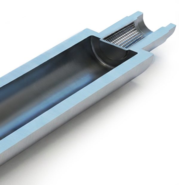

1) Monolithic rotor shafts (made from a single piece)
Monolithic rotor shafts are manufactured from a single blank—typically from bar stock or a saw-cut section. A defining feature is the continuous material structure without any joints.
Typical features:
  • No tolerance chains on the joint side or thermal effects from welding
  • Geometric reference points (e.g., bearing locations, centers) can be established very “directly”
  • Particularly suitable when installation space, material, and geometry allow for a one-piece design
For manufacturing, it is crucial that the functional surfaces—especially bearing surfaces and gear teeth—are produced with high dimensional and positional accuracy relative to one another. At high motor speeds, the importance of concentricity and surface quality becomes even more apparent.

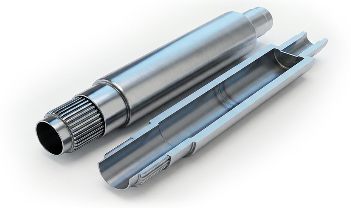

2) Assembled/joined rotor shafts (multi-part)
In the case of assembled rotor shafts, the component consists of at least two, and often three, individual parts that are joined during the manufacturing process to form a complete rotor shaft. Common methods include:
  • Laser welding (high precision, easily automatable, suitable for batch production)
  • Friction welding (robust joining process, also suitable for series production)
Why multi-part?
Multi-part designs arise, for example, from installation space requirements, material combinations, functional integration, or the goal of manufacturing individual sections more cost-effectively. At the same time, the demands on process control increase: Joints affect concentricity, surface quality, dimensional accuracy, and potentially also warping behavior in subsequent processes.
Especially in the context of e-mobility, joined rotor shafts are therefore only economical if joining and ancillary processes (e.g., cleaning, pressing, preheating) have a stable link-up and are quality-assured—because every additional operation affects cycle time, process, and overall accuracy.
Assembled rotor shaft with a laser weld. Several individual parts are joined with precision to form a functional shaft.
Multi-piece rotor shaft joined by laser welding. The joint is visible and shows the transition between the individual components of the shaft.

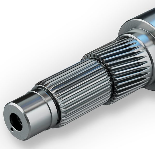

3) Interface Variants to the Gearbox
Irrespective of the design, the configuration of the interface to the gearbox side is crucial.
Interface between the rotor shaft and gearbox in the electric drive.
Illustration of the mechanical interface between the rotor shaft and the gearbox. Shown is the positive-lock torque transmission via the tooth profiles in the electric drive.
Three typical variants have become established here:
Cross-section of the internal gear teeth on a rotor shaft.
Close-up view of a rotor shaft with internal gear teeth. The internal gear teeth serve as a form-fit interface for torque transmission to the gearbox.
a) Internal gear teeth (spline)
The rotor shaft has internal gear teeth in the form of a spline. This transmits torque via a positive connection to a mating part (e.g., shaft/hub).

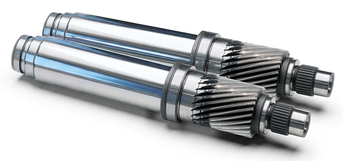

c) Rotor shaft with drive teeth (also serving as input shaft)
In this variant, the rotor shaft already features the drive teeth— additionally it serves as an input shaft to the gearbox.
Characteristics:
  • Functional integration: fewer interfaces/components
  • At the same time, higher requirements for gear tooth quality, because the teeth not only couple but also mesh during operation
Particularly sensitive with regard to noise behavior, surface quality, and flank modifications
