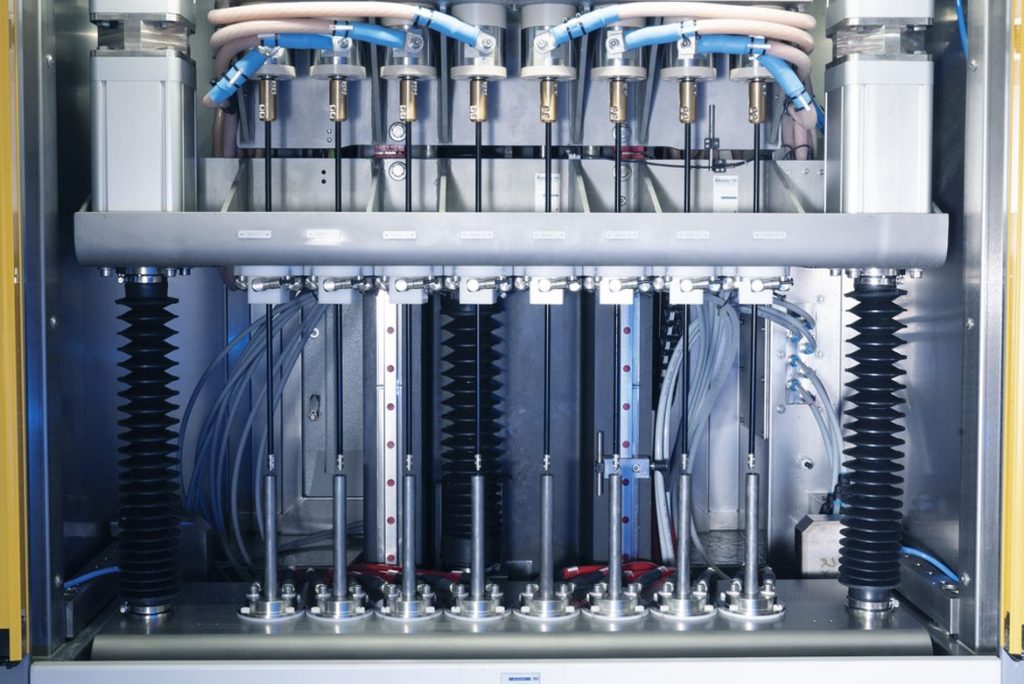

During ECM Rifling the cathodes enter the tube blank and remove the excess material.
The cathodes enter the tube blank and remove the excess material.
How does the ECM process for manufacturing field tension profiles work on your PI platform, and which geometries can be realized with it?
We have developed a universal and modular PI platform that uses a special rifling cathode to produce field rifling profiles. Different geometry requirements such as “polygon”, “progressive” or “standard” can be achieved  with up to eight tool cathodes. The production process itself is quick: the operator places eight blanks in the workpiece holders. The eight cathode tips then move just above the blanks and remain there briefly until a trailing sealing unit surrounds them. The ECM- process begins, with the cathodes gradually moving deeper into the tube blank, removing the excess material.
