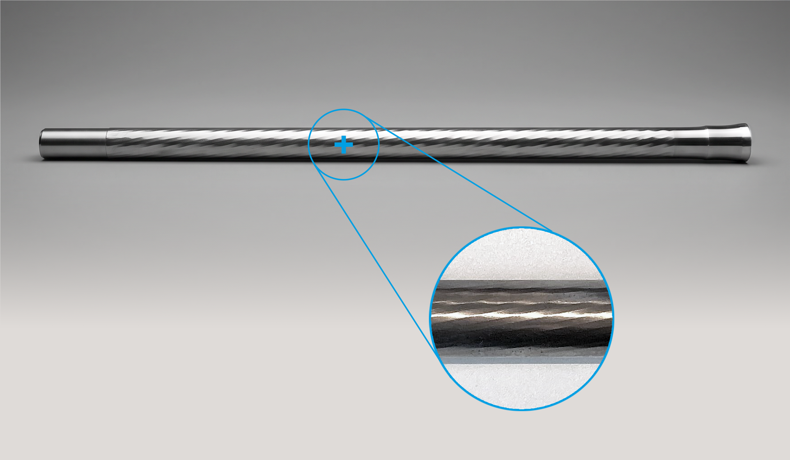

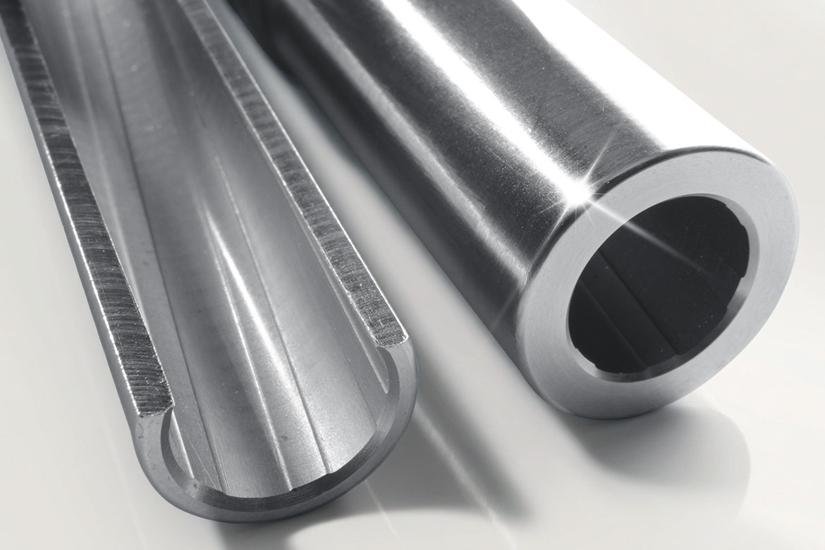

Requirements for the Finished Weapon Barrel
Before examining the individual machining steps, it is worth looking at the requirements the end product must meet. A rifle or pistol barrel is a high-precision component whose function depends directly on the dimensional accuracy and surface quality of both the internal and external contours.
Typical requirements for a rifle barrel:
  • Concentricity between centers: less than 0.1 mm over a total length of approximately 600 mm
  • Length-to-diameter ratio: up to 36 × D – in this example, a diameter of 15 mm with a length of 497 mm plus the chamber area
  • Internal contour with rifling and lands: land tolerances of approximately 5 µm, rifling profile tolerances of around 50 µm, rifling depths (rifling dimensions) typically 0.2 mm for calibers up to 0.5″
  • Cartridge chamber: precisely formed and protected from damage during subsequent external machining
  • Length tolerance between the cartridge chamber taper and the outer surface: tightly controlled, as it is critical for subsequent coupling with the breech system
  • Internal surface quality: Ra up to 0.1 µm, depending on the material
The material used is typically designed for forming processes (hammering) and consequently exhibits poor chip breaking properties. Combined with the slenderness of the workpiece, this results in a manufacturing challenge that can only be economically solved with carefully coordinated workholding technology, tool guidance, and measurement technology.
Cross-section of a gun barrel with rifling and lands. The precision internal contour is visible.
Cross-section of a gun barrel with precision-formed rifling grooves and lands. The internal geometry is critical for guidance, twist, and dimensional accuracy.

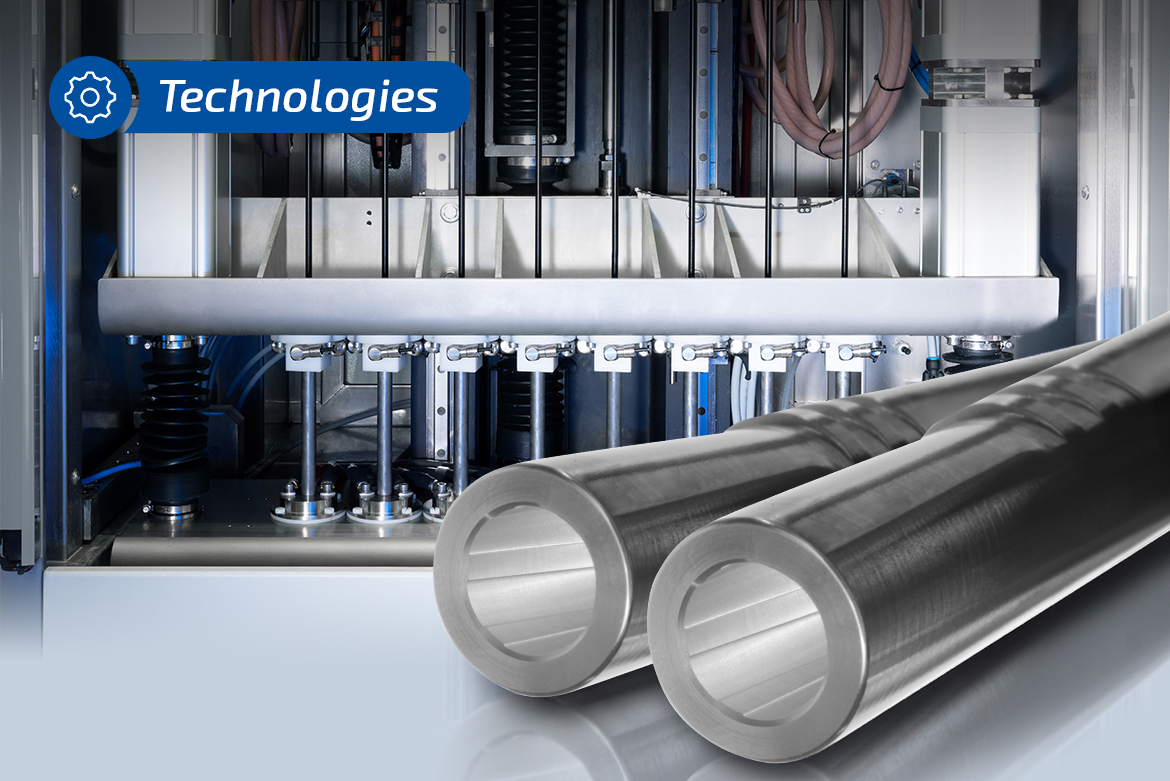

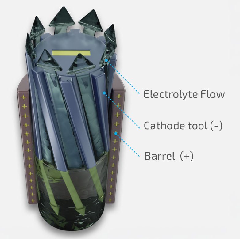

Rifling Variant 2: ECM Rifling (Electrochemical Machining)
Electrochemical machining (ECM) is a non-contact process: A pulsed current flows through a conductive electrolyte between the metallic workpiece (anode) and the tool, known as the cathode. This removes metal in a controlled manner – without mechanical force, without heat generation in the workpiece, and with only minimal wear in the traditional sense. No subsequent heat treatment or straightening of the barrels is necessary. In addition, all common metals, including titanium and Inconel, can be machined.
Characteristics of ECM rifling:
  • Feed rate: approximately 85 mm/min (depending on the material) to achieve a surface roughness of Ra 0.1
  • Field tolerance: approximately 5 µm; rifling depth tolerance: approximately 50 µm
  • Rifling depth: 0.2 mm for calibers up to 0.5″
  • No mechanical stresses or thermal stresses on the workpiece – no straightening operation required
  • Hardened materials machine at the same speed as soft materials.
  • Smooth transitions between the field and the draw reduce deformation forces on the projectile and minimize wear on the barrel
  • Barrels already externally finished can also be machined, since no subsequent straightening operation is required

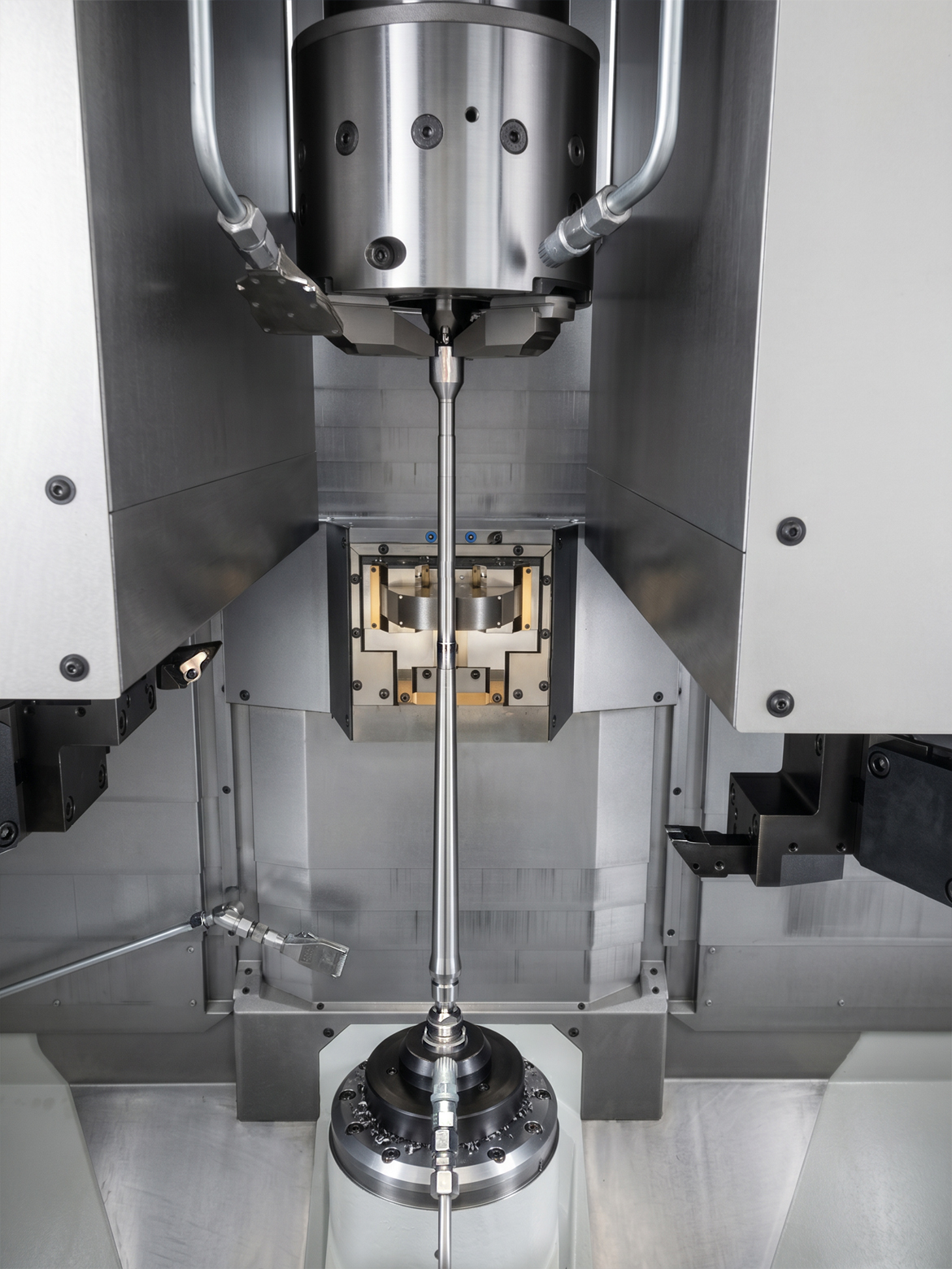

Chamber and final external turning
Regardless of the rifling method selected, the barrel’s final external machining follows. This step turns the final diameters, lengths, and transitions to the chamber side – both machining operations can run on our EMAG VT series. Due to the existing internal contour, special requirements apply here:
  • The internal contour of the chamber must not be damaged. Direct clamping in the taper is not an option.
  • An additional allowance of typically 2 mm on the end face, combined with an internal chamfer (e.g., 2 × 60°), creates a clean centering surface for turning.
  • This allowance is removed at the end of the process along with the chamfer.
From a process engineering perspective, this finishing operation is the most demanding turning operation in the entire process chain. The next section covers these challenges in detail.

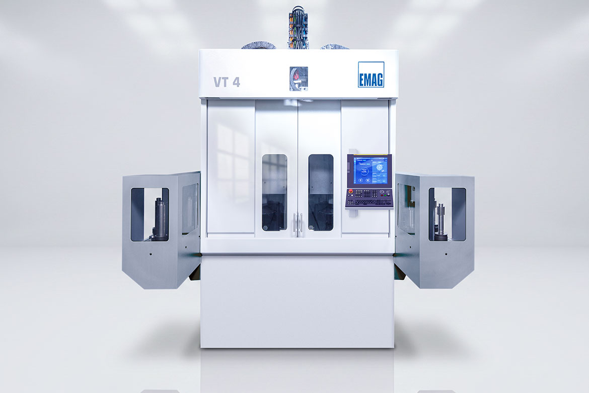

The Right Machine: VT 4 in the Long Version
The long version of the EMAG VT series has proven itself for long rifle barrel turning. The standard version offers 870 mm of space between the spindle and the tailstock; the long version provides up to 1130 mm.
Additional machine requirements:
  • Two turrets (typically BMT65), with the left side optionally equipped with a Y-axis and driven tools for the milling operations in OP 70
  • Main spindle with sufficient power (e.g., 29.3 kW)
  • Center drive with a movable axis (deep-hole drilling up to 380 mm)
  • Drilling spindle with high-pressure system mounted at the bottom
  • Movable steady rest with electronically controlled positioning
  • Hydraulic tailstock, retractable and with adjustable clamping force
  • Standard Type O transport system for up to 27 workpieces – the existing standard automation handles long runs without requiring a custom solution
