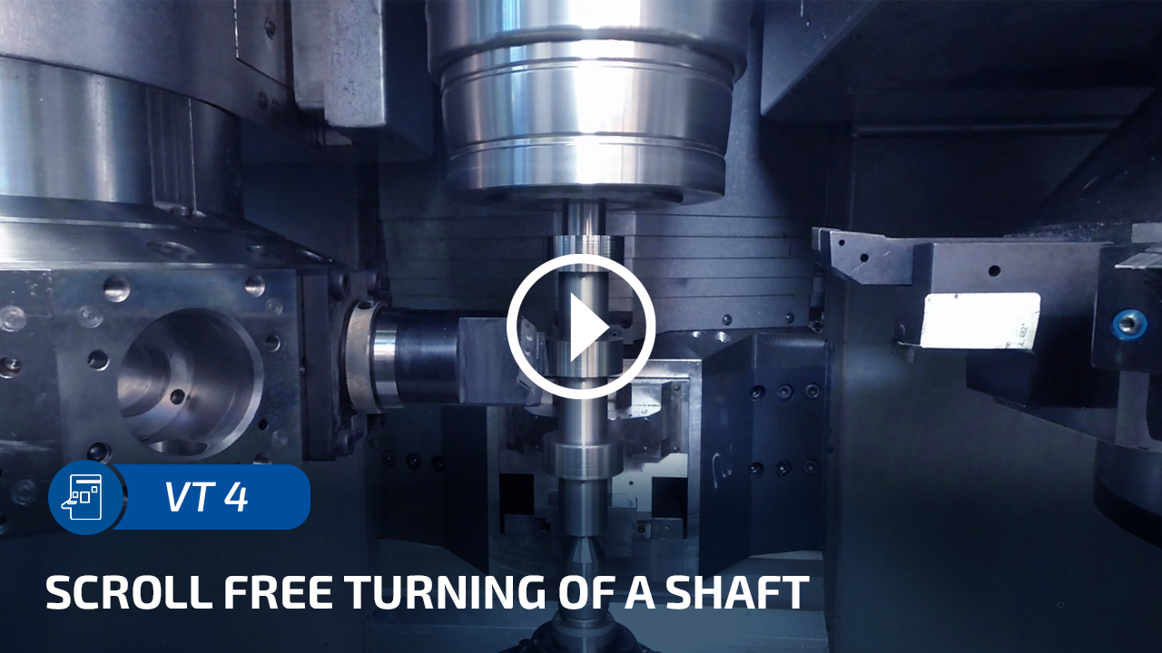

Peeling tool machining a vertically clamped shaft in the work area of the EMAG VT 4
Scroll free turning in practice: In the work area of the EMAG VT 4, the scroll free turning tool machines a vertically clamped shaft.

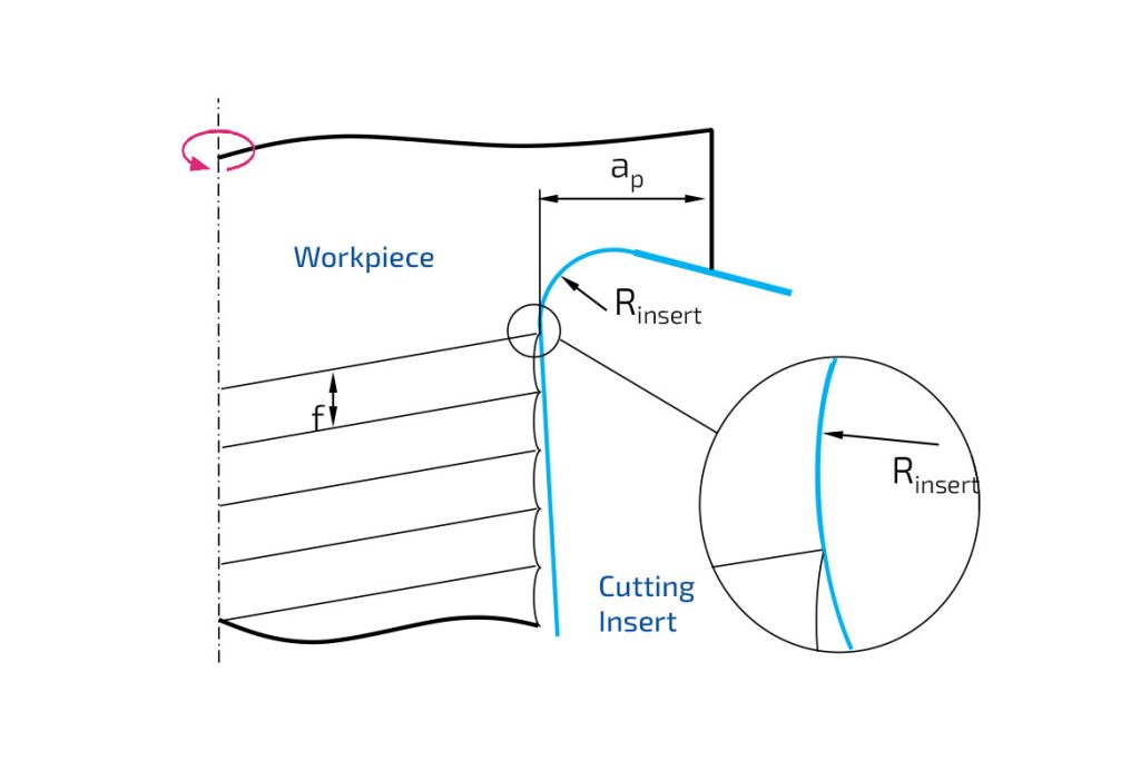

1. Why was scroll free turning developed?
The trigger was the twist. In conventional longitudinal turning, the corner radius of the cutting edge, the feed rate, and the rotation of the workpiece create a fine, thread-like groove structure on the surface. On a seal seat, this structure acts like a screw conveyor: it transports oil beneath the radial shaft seal ring—causing the system to leak. For this reason, many drawings for seal seats explicitly require the surface to be free of tool marks, usually combined with surface roughness values of Rz 1 to 4.
For a long time, such surfaces could only be produced by grinding. The goal of EMAG’s technology development was to create an alternative with a defined cutting edge that runs directly on the lathe – without an additional grinding operation and without cutting fluids. The result is scroll free turning, which has been in use in series production projects for well over a decade.
Formation of swirl due to the cutting radius and feed rate during conventional turning.
In conventional turning, the cutting edge radius and feed rate create a thread-like groove structure known as a spiral. At seal seats, this spiral channels the oil beneath the radial shaft seal.

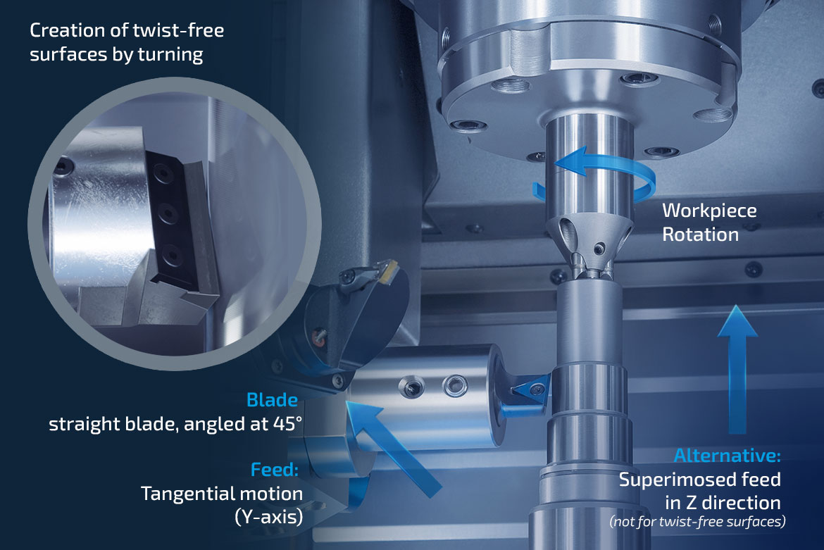

2. How does scroll free turning work?
In scroll free turning – sometimes also referred to as tangential turning – a straight cutting edge up to 50 millimeters long is used, set at a 45-degree angle. The workpiece rotates as is customary in turning. However, the cutting edge does not move axially along the workpiece but sweeps tangentially past it; a superimposed compensating motion ensures the precise cylindrical shape.
The key effect: The point of contact continuously moves along the cutting edge. Each point on the cutting edge is in contact for only a fraction of a second; the chip rolls off the cutting edge, carrying away almost all of the process heat. This allows for high cutting speeds of 250 m/min and more, with completely dry machining. For longer machining lengths, a Z-axis movement can also be superimposed; this further increases productivity, but the surface is generally no longer free of twist.
Operating principle of scroll free turning: a cutting edge set at a 45-degree angle and tangential feed against the rotating workpiece.
The operating principle: A straight cutting edge set at a 45-degree angle sweeps tangentially past the rotating workpiece. The point of contact moves along the cutting edge.

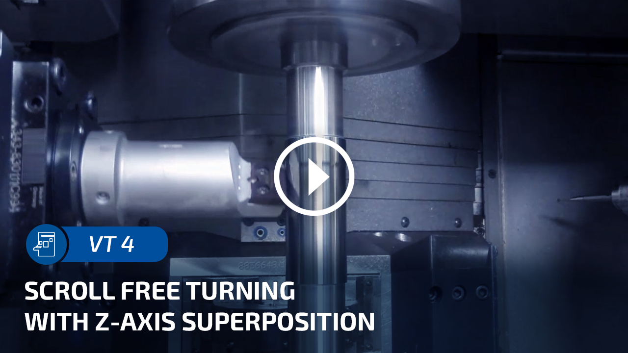

Scroll free turning with superimposed Z-movement on a long shaft during soft machining.
Soft machining with superimposed Z-axis movement: This allows even long diameters, such as the laminated core, to be finished-machined very quickly—with feed rates of up to 1.5 mm per revolution.

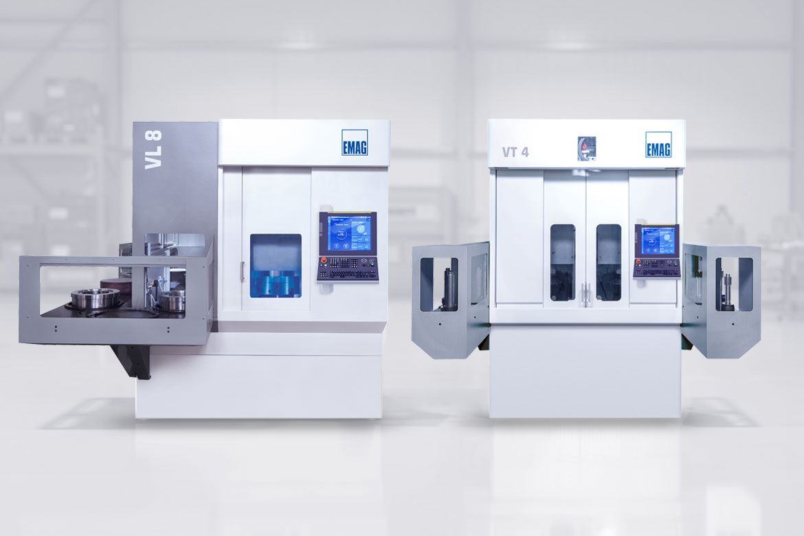

5. What machines and requirements are needed for this process?
Scroll free turning requires a lathe with a Y-axis or a swiveling turret and – due to the comparatively high radial forces – a stable workpiece clamping system, such as a collet chuck or the EMAG shaft chuck, supplemented by a steady rest if necessary. At EMAG, the process is primarily used on the vertical shaft lathes of the VT series; for flange-shaped components, it is also used on the VL series.
No specialists are required at the machine: A specially developed EMAG peeling cycle handles the calculation of movements in the background. The machine setter simply enters parameters such as diameter, feed rate, and cutting speed and adjusts the tool as in normal turning operations – a CAM system is not required. Limitations: The process is designed for O/D (Outer Diameter); I/D (Inner Diameter) and end faces are not possible.
