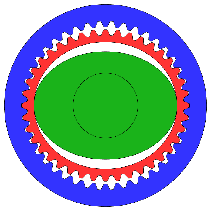

Strain wave gearboxes differ fundamentally from classic gearboxes in that their mode of operation is not based on rigidly intermeshing gears. Instead, this type of gearbox makes targeted use of the elastic deformation of a thin-walled gear to achieve a high reduction ratio, a compact design, and low-backlash power transmission.
A strain wave gear consists essentially of three functionally coordinated components: the wave generator, the flexspline, and the circular spline. The wave generator is usually connected to the drive shaft and consists of an elliptical cam that deforms the flexspline via a thin-walled bearing. The flexspline is a cylindrical, elastic gear with slightly fewer teeth than the surrounding rigid circular spline.
The rotation of the wave generator causes the flexspline to undergo continuous elliptical deformation. As a result of this deformation, the flexspline engages with opposite tooth profiles on the circular spline. The different number of teeth on the two gears is crucial here: with each revolution of the wave generator, the point of engagement shifts by a few teeth. This results in a slow relative movement of the flexspline relative to the circular spline and thus the desired reduction ratio.
The particular advantage of this principle is that high reduction ratios can be achieved in just one gear stage. At the same time, the elastic preload of the flexspline ensures low-backlash meshing. For the user, this means precision movements, compact sizes, and very good repeat accuracy, especially in applications with frequent direction changes and high control quality requirements.
Schematic representation of a shaft drive with flexspline, circular spline, and wave generator. Shows the basic principle of strain wave gear technology.
Schematic representation of a strain wave gear with circular spline, flexspline, and elliptical wave generator.
Source: Jahobr, CC0, via Wikimedia Commons, https://upload.wikimedia.org/wikipedia/commons/2/21/HarmonicDriveAni.gif

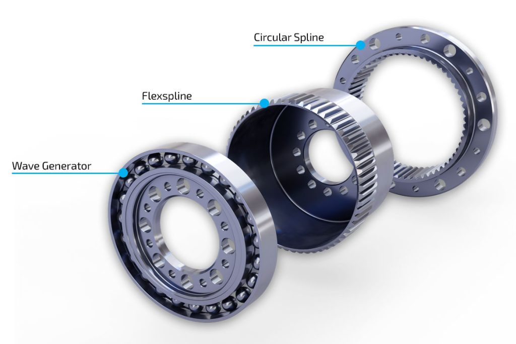

The strain wave gear enables high-precision motion transmission in a very compact design. It is used wherever rotary motions not only have to be transmitted, but also precisely controlled and reproducibly positioned. A central purpose is low-backlash torque transmission. Due to the elastic deformation of the flexspline, several pairs of teeth engage simultaneously, which largely eliminates tooth flank backlash. This enables high repeat accuracy and stable control behavior, even with frequent changes in direction. At the same time, very high reduction ratios can be achieved in just one gear stage. The reduction ratio results from the small tooth difference between the flexspline and circular spline. The even load distribution over many teeth also allows high torques with comparatively small dimensions.
Exploded view of a shaft drive with wave generator, flexspline, and circular spline. Illustrates the structure of strain wave gear technology.
Exploded view of a strain wave gear with wave generator, flexspline, and circular spline.

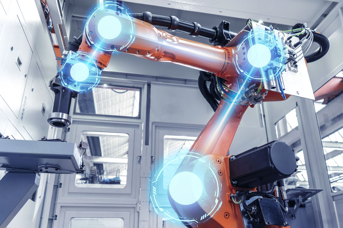

Industrial robots with highlighted joint axes. Illustration of typical areas of application for strain wave gearboxes in robotics.
Industrial robots with marked joint axes in which strain wave gears are used. The illustration shows typical areas of application for compact gears in robotics.
