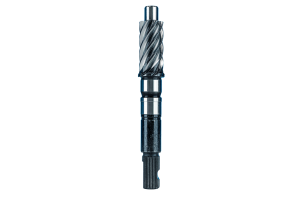

Close-up of a steering pinion
Skiving to achieve the final surface quality and dimensional accuracy of steering pinions.

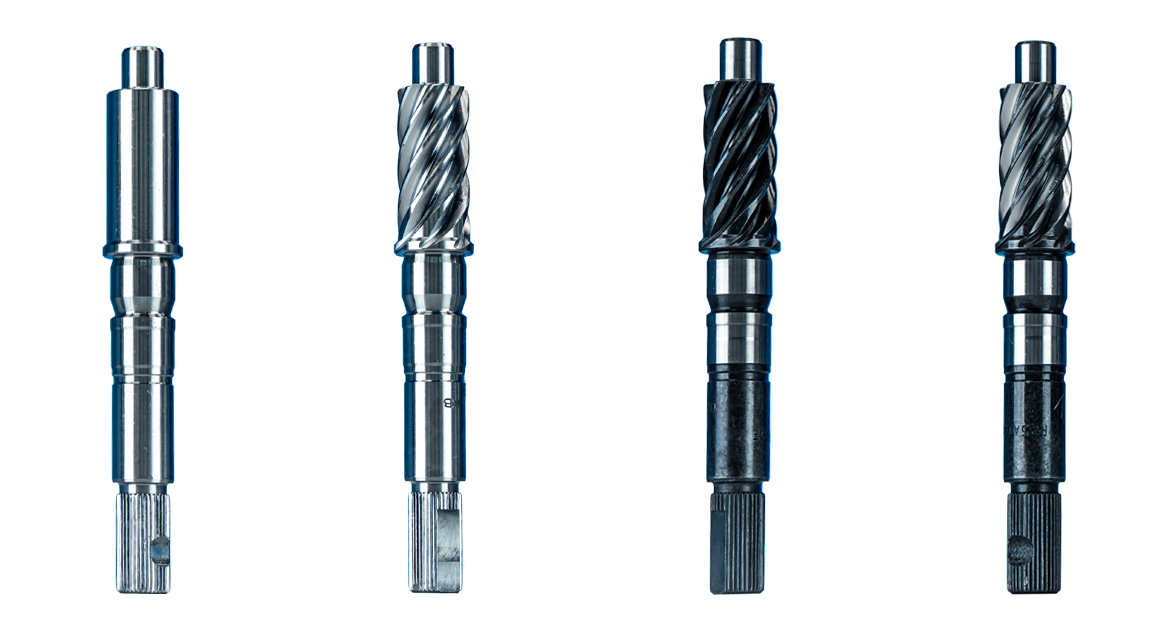

Illustration of the manufacturing stages of a steering pinion, starting with the turned blank and ending with the finished, gear-cut, and ground end product.
The complete process chain from turning to the toothed steering pinion.

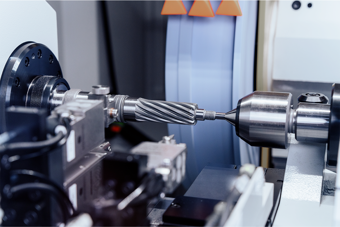

View of the work area of the WPG 7 during the grinding process on the bearing seats of a steering pinion.
Precision grinding of the bearing seats of a steering pinion after the hardening process on the WPG 7.

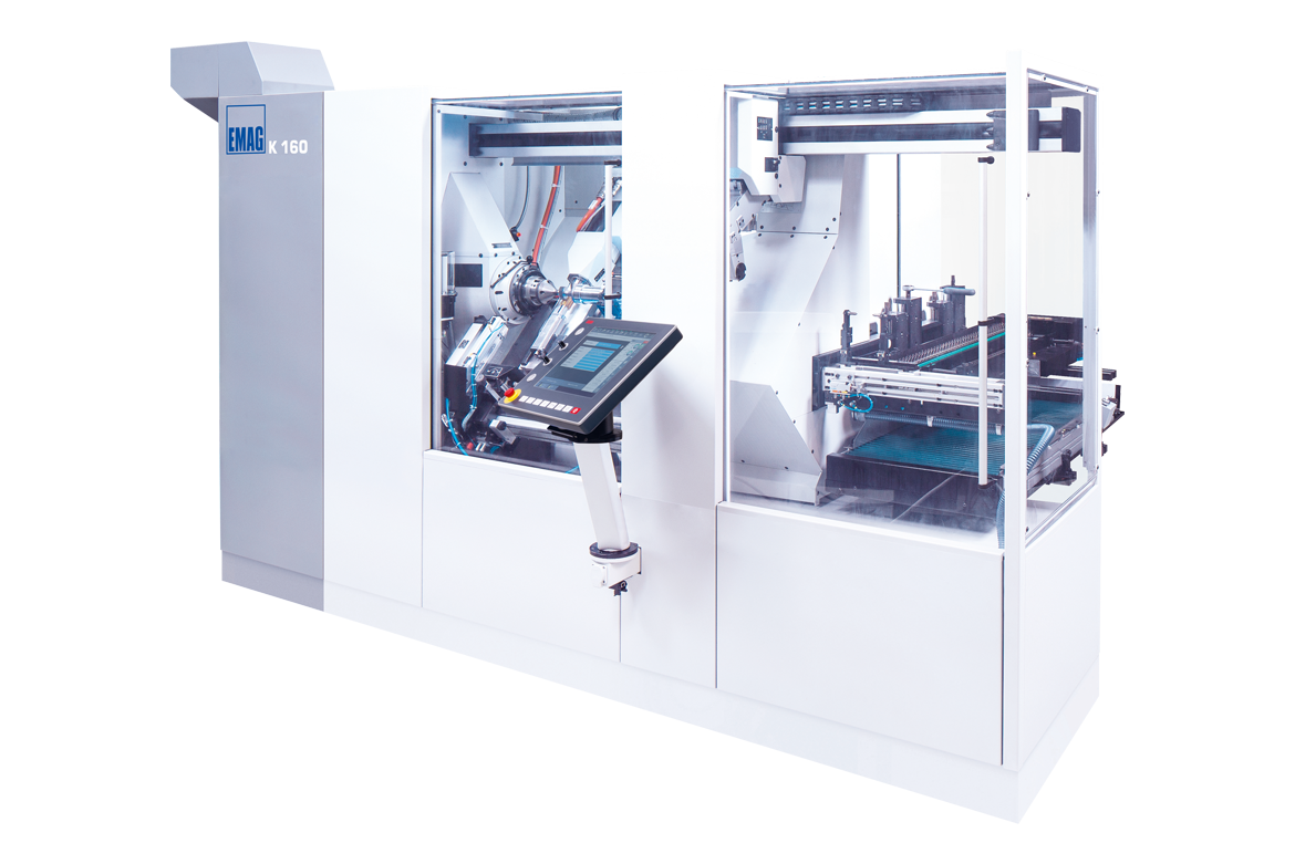

Let’s move on to gear hobbing before hardening. What makes the K 160 gear hobbing machine particularly suitable for this process step?
The K 160 was specifically designed for high-productivity applications such as steering gear gear cutting. A key feature is its high dynamic performance with hob speeds of up to 12,000 rpm, which enables short machining times. For gear cutting in the soft state, we use shaft-type hobbing cutters that are optimally designed for the maximum shift travel of 160 mm. This enables economical use of the tools over their entire service life.
Another decisive factor is automation: The K 160 is equipped with a gantry loader and a dual-rotation gripper that feeds the workpieces in the correct orientation in just a few seconds. This automation significantly reduces non-productive time and increases process reliability, as errors in manual handling are eliminated.
Exterior view of the EMAG K 160 gear hobbing machine, specialized in the high-productivity manufacturing of steering pinions.
The EMAG K 160 enables cycle times of less than 30 seconds for gear cutting of steering pinions.

During hardening – whether by case hardening or induction hardening – distortions in the workpiece are inevitable due to the heat treatment. These distortions lead to deviations in the bearing seats and in the gear tooth geometry. To correct the distortions in the bearing seats, we rely on precision grinding with the WPG 7. We achieve the required quality of the hardened tooth profiles through skiving on the K 160.

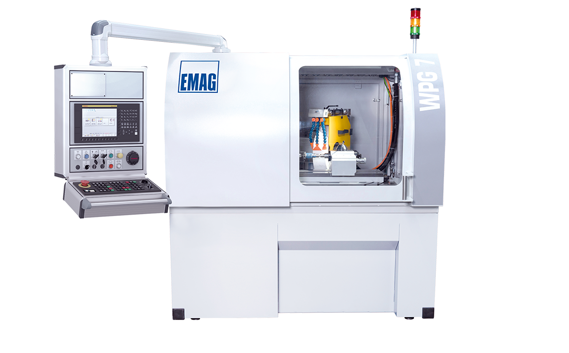

The WPG 7 is equipped with high-precision position measurement systems on the X and Z axes and features a thermally stable base body that ensures constant conditions even during continuous operation. Depending on requirements, the workpiece spindle can be equipped with a stationary or rotating tip (MK4 or W20), offering flexibility for various steering pinion geometries. The machine is optimally designed for workpieces up to 250 mm in length and weighing a maximum of 30 kg.
General view of the EMAG WPG 7 external grinding machine.
The compact WPG 7 corrects hardening-induced distortions on the bearing seats of the steering pinions with micrometer precision.

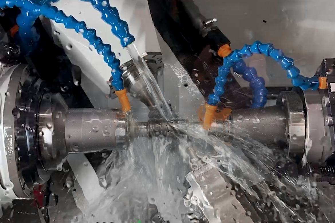

Close-up of the shaving process, in which the tooth profiles of a hardened steering pinion are machined with the highest precision.
High-precision finishing of a hardened steering pinion by skiving to achieve gear quality DIN 7.
