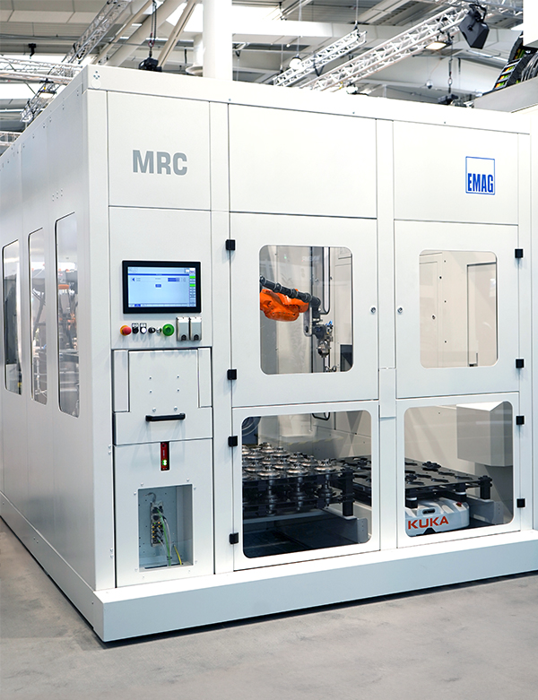

A key feature of the MRC is its compact, transport-optimized design. With a width of 2.70 meters, the robot cell can be transported by truck as a complete unit – no dismantling required. All modules are mounted on a common base plate, which is both crane- and forklift-compatible.
Modular robot cell MRC from EMAG. Solution for automated workpiece handling in production.
The MRC modular robot cell from EMAG for automated workpiece handling. Compact design meets flexible automation concepts.
This design enables full pre-commissioning. Processes, motion sequences, gripper functions and interfaces can be set up and tested in advance. On site, customer effort is limited to aligning and connecting utilities such as compressed air, network and electricity. As a result, commissioning times are significantly reduced.
This concept has already proven itself in practice: In customer applications, the MRC was fully commissioned within a few days of delivery – allowing for faster ramp-up and predictable implementation of automation projects.

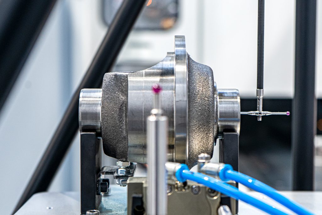

Tactile measurement of a workpiece in the MRC robot cell. Integration of measuring functions in automated production processes.
Workpiece measurment within the MRC robot cell with tactile measuring technology. Additional functions such as measuring can be integrated directly into the cell.

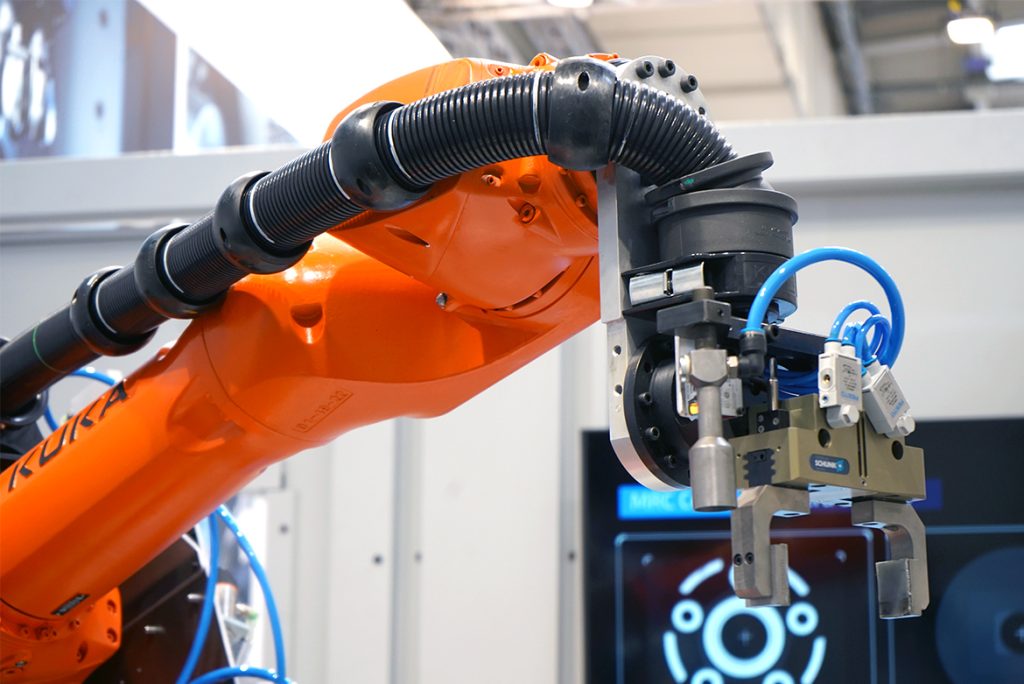

Engineering effort is a key factor for economical automation. MRC relies on a universal flange system that can accommodate different gripper modules. Pneumatic, centric or parallel grippers can be mounted in different sizes.
The advantage of this concept is the reduction of project-specific special solutions. In many cases, customization is limited to the gripper jaws, while the flange, gripper module and interfaces remain unchanged. This simplifies the design while also reducing complexity in servicing and spare parts management.
