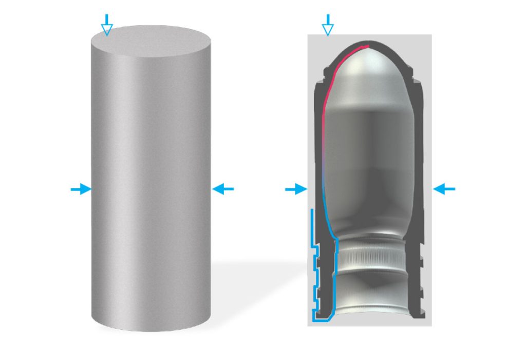

Process plan OP 10: Raw-parts from solid material and projectile body with turned inner contour on the EMAG VL 8.
Process plan OP 10 on the VL 8: Solid raw-part (left) and machined workpiece (right) with drilled and turned internal contour as well as rough-machined bottom area (red).
Three operations, three setups
  • OP 10 – Drilling and Internal Turning: The raw-part is clamped at what will later be the head end.  The internal contour is first drilled from solid, then rough-turned into a preliminary contour, giving the cavity an egg shape. In the same setup, the base area is rough-machined both internally and externally. OP 10 is the operation with the largest material removal volume and the longest cycle time.

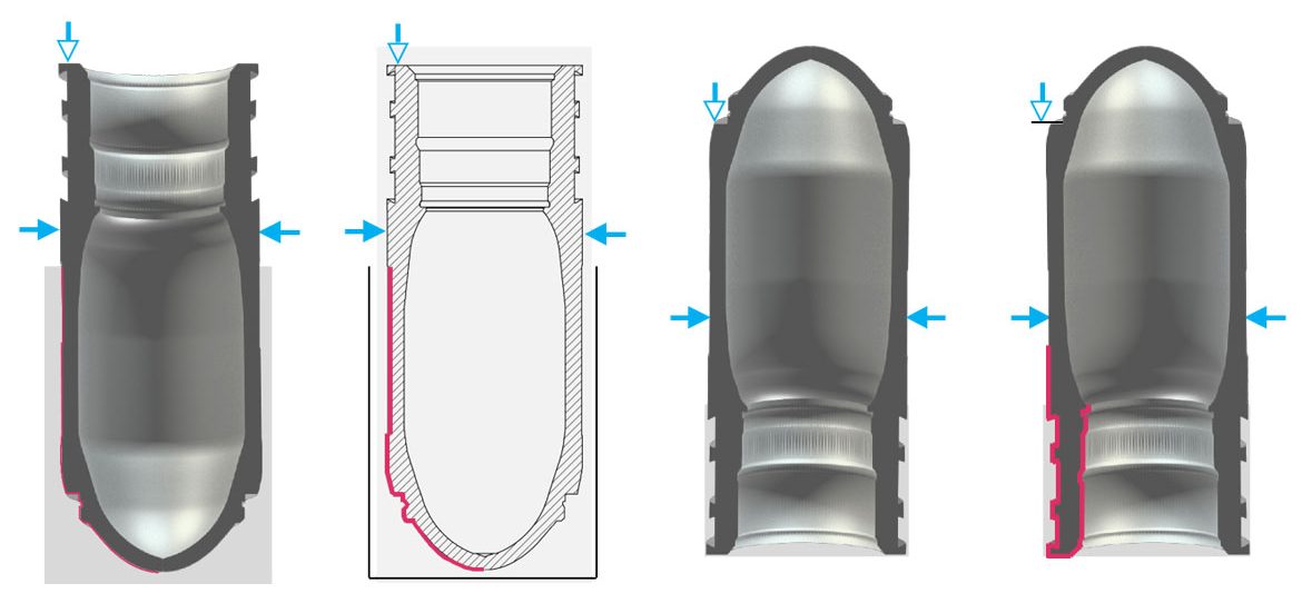

  • OP 20 – External Contours: The workpiece is rotated 180 degrees and clamped at the pre-turned base. This operation mahcines the body diameter, the ogive, and the external thread at the head.
  • OP 30 – Finishing: The workpiece returns to its OP 10 orientation. The outer diameter (OD)and iInner diameter (ID) at the base are finished, including the outer clearance cuts and the internal thread.
Rough-machining in OP 10 and finish-machining in OP 30 are kept separate for quality reasons: The required tolerances on diameters, threads, and clearances can only be held reliably in a separate finish-machining operation after external machining.
Process plans OP 20 and OP 30 for the projectile body of the 120-mm armor-piercing ammunition on the EMAG VL 8.
Left: OP 20: Workpiece rotated 180 degrees; machining of external contours, ogive, and external thread. Right: OP 30: Finishing of the bottom, undercuts, and internal thread (red).

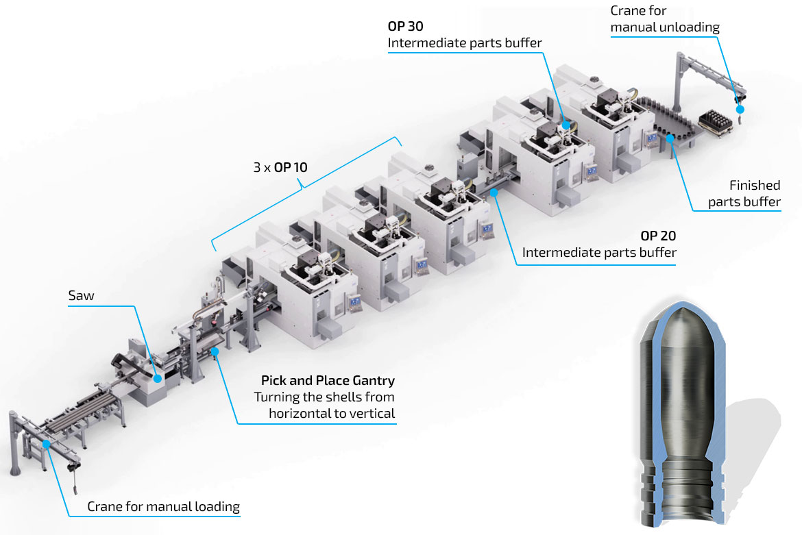

Balanced cycle times are crucial for the layout. OP 10 takes about three times as long as OP 20 or OP 30. To keep any machine from sitting idle, three VL 8s run OP 10 in parallel, with one each in OP 20 and OP 30—a coordinated system of five machines. If a forged or cast blank with a preformed cavity is available, OP 10 machining volume drops significantly, so two machines, or even one, are sufficient there. The concept also scales in both directions: from compact configurations with a few manually loaded machines for small batches to high-volume production solutions with 20 machines across four production cells. The line also integrates part cleaning, centralized raw part feeding and finished part storage.
Material Flow and Automation
At the start of the line, bars are manually loaded by crane and cut to length on a saw. A gantry loading system orients the sections from horizontal to vertical and transfers them to the TrackMotion system. TrackMotion runs on a rail behind the machines at up to 150 m/min horizontally and 25 m/min vertically. The programmable electric gripper rotates workpieces to change their orientation between OP 10, OP 20, and OP 30.
Intermediate buffers sit between the operations, with a finished-parts buffer at the end of the line where components are removed by crane. The buffers decouple the operations, so the remaining machines keep running if one machine is down for a tool change or a malfunction. This increases output and Overall Equipment Effectiveness (OEE).

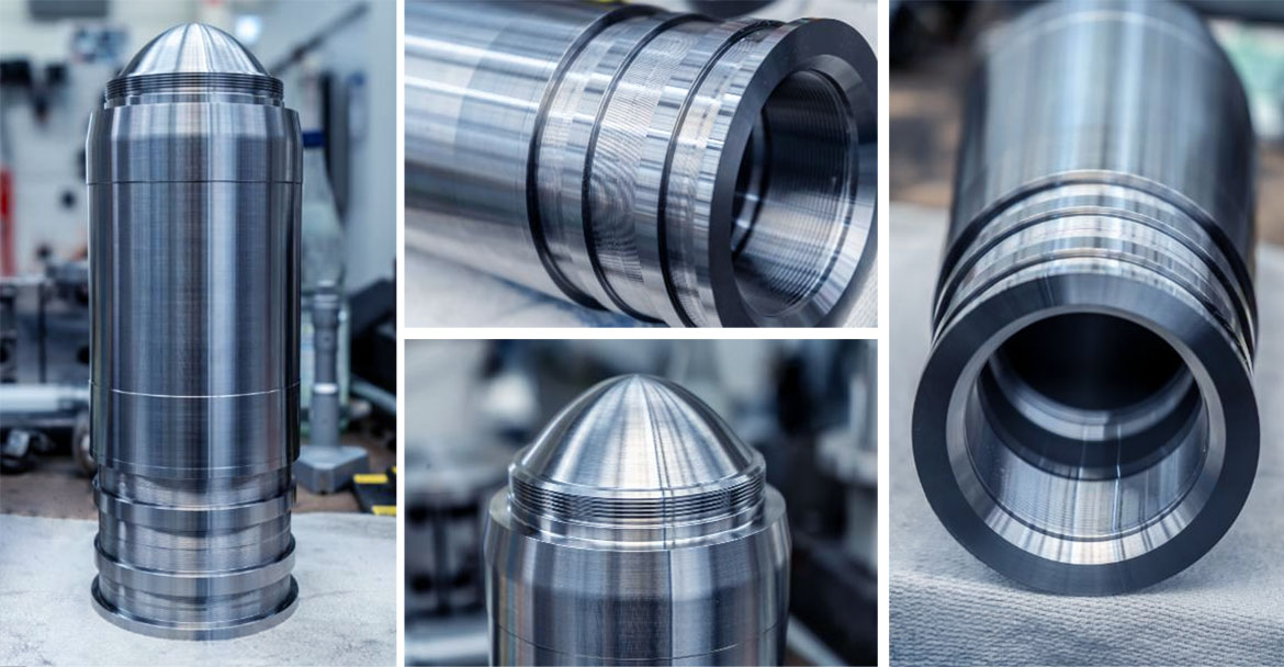

Turned sample parts of the 120-mm armor-piercing ammunition with ogive, external thread, undercuts, and internal thread.
Machined projectile bodies from the tests at EMAG: ogive with external thread, base area with undercuts and internal thread.
Machining Tests: Verified Cutting Parameters
Because the material is very hard and doesn’t break chips well, EMAG ran extensive in-house tests on this component. The tests systematically varied cutting speeds, feed rates, and tools for drilling from solid, internal and external turning, and threading. The result is validated cutting parameters for each operation, so cycle times can be calculated reliably and the required surface finishes achieved.
