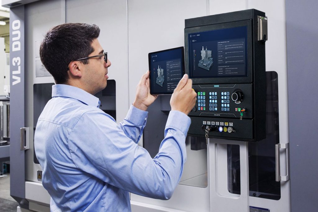

Service technician uses EDNA Health Inspect to analyze a VL lathe.
A service technician uses EDNA Health Inspect on a VL lathe while the analysis results are displayed on a laptop.

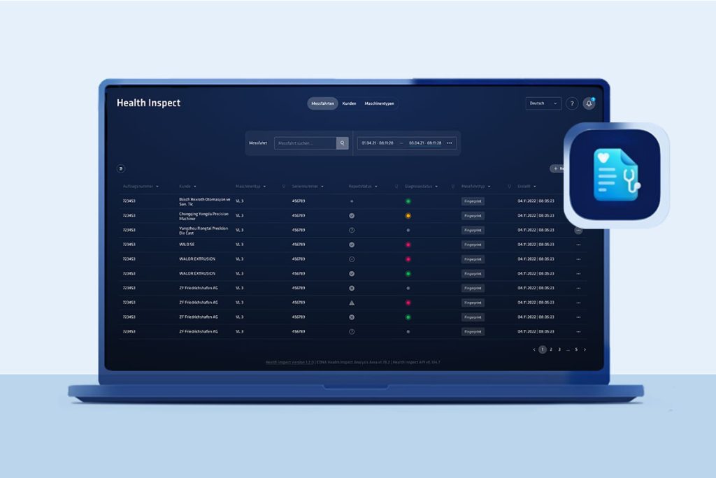

How does the traffic light system work within EDNA Health Inspect and how does it help users?
The traffic light system is a simple but effective method of recognizing the current condition of the machine axles at a glance. It displays the diagnostic status in the form of traffic light colors: Green means that everything is OK, yellow indicates potential problems that should be monitored and red signals an urgent need for action. This system helps our service technicians and customers react quickly and efficiently to potential problems.

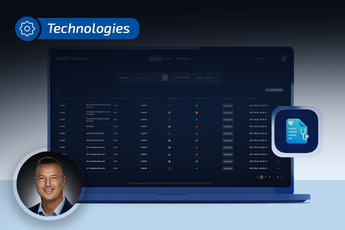

EDNA Health Inspect traffic light system on a screen with colored status indicators
A screen shows EDNA Health Inspect’s traffic light system with green, yellow and red to indicate the status of the machine axes.

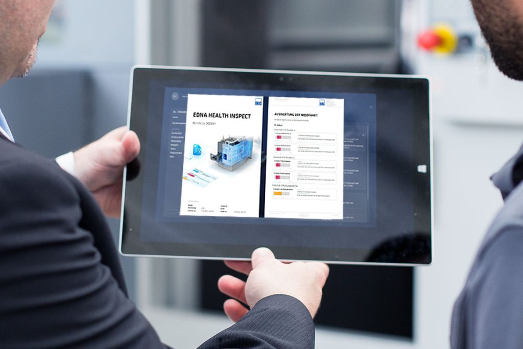

How are the analysis results presented and what information does the customer receive?
The results are summarized in a detailed report. This contains an overview of the machine axes/main spindles, the identified indicators, the interpretation of the data and specific recommendations for action. This information is reproducible and provides the customer with a clear basis for initiating the necessary maintenance or repair measures. Both our customers and our service technicians particularly appreciate the fact that this process is fully automated and no manual reworking is required.
