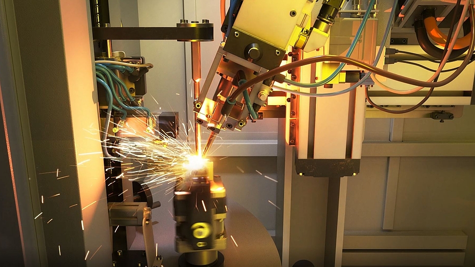

ELC 1200 V Vertical Laser Processing Machine for Shaft Components
The vertical laser processing machine ELC 1200 V is designed for workpieces up to 1200 mm in length and impresses with its fast processing, a small footprint and extreme ease of operation. In addition to laser welding, other laser processes such as laser cleaning and laser hardening can be used on this new machine.
ELC 1200 V Vertical Laser Processing Machine with EDNA HMI for easiest operation
The ELC 1200 V offers maximum flexibility in production. The 3-axis laser lens is NC-controlled and can be configured to meet a wide variety of individual requirements.
In combination with the NC-controlled C-axis of the clamping device, the welding lens can also produce interpolated welds. This means that, for example, a quick conversion for laser welding of families of parts can be implemented without any problems. The clamping system is, of course, just as flexible as the laser lens.
