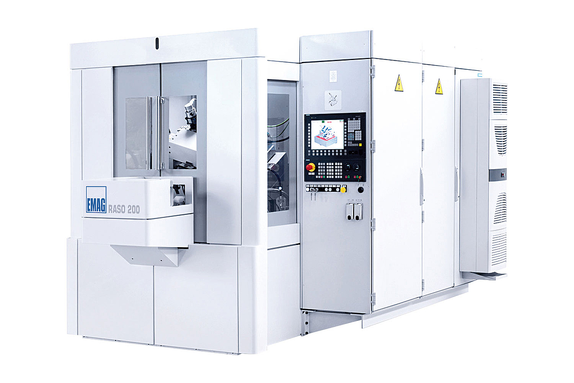

Shaving Machine RASO 200
The RASO 200 shaving machine is the ideal match for automatic transmission gears, motorcycle gears, pump gears.
RASO 200 Shaving Machine for Automatic Transmission Gears, Motorcycle Gears & Pump Gears
Thanks to its “lathe-like” structure and its compact design, RASO 200 shaving machine has the same stiffness of larger machines.
Cycle speed and flexibility are at the top. The RASO 200 shaving machine is the ideal match for automatic transmission gears, motorcycle gears, pump gears. It is available in 3, 5 and 7 controlled axes configuration (modular concept).
RASO 200 is able to perform five different cycles:
  • Plunge
  • Parallel
  • Underpass
  • Diagonal
  • Mixed Cycles
Advantages RASO 200
  • All shaving processes are possible depending on the axes configuration
  • Very fast internal automation with a rotation drum
