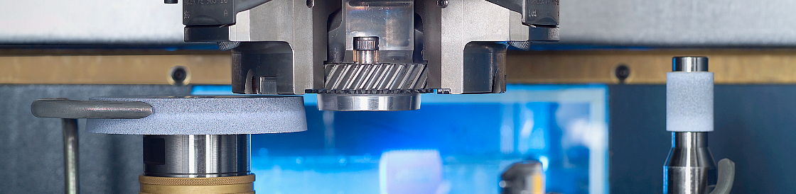

Finishing a gearwheel with hard turning and grinding operations
Finishing a gearwheel with hard turning and grinding operations on an EMAG VSC 250 DDS.
Hard turning / grinding: all precision-machining processes on a single machine
Combination machining hard turning and grinding of shafts. All precision-machining processes on a single machine: CBN grinding, hard turning and scroll-free turning, providing exceptional flexibility in the precision-machining of shafts.
