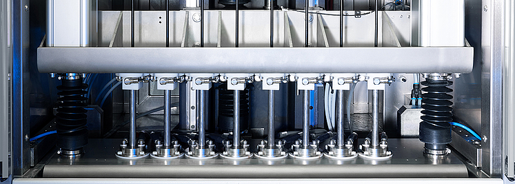

ECM technology: Work area with rifling module for parallel machining. Multiple workpieces are electrochemically machined simultaneously.
The Rifling Module demonstrates the principle of ECM parallel machining. Up to eight workpieces are machined simultaneously. This results in short cycle times and high repeatability.
