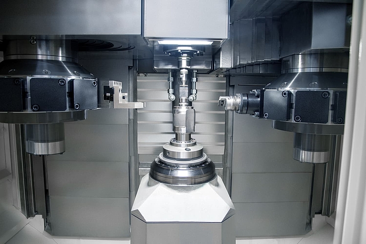

EMAG VT series machine performing CNC turning of an outer race using peel turning technology
An EMAG VT series machine performing Scroll-free turning on an outer race. The 4-axis machining and integrated automation ensure short cycle times. The highest surface quality is achieved without an additional grinding operation.
