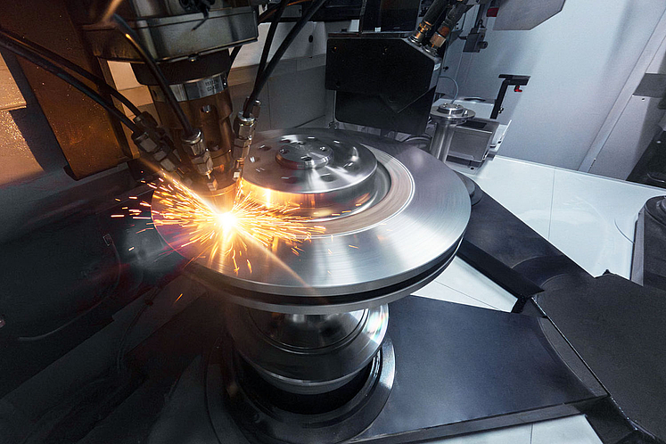

Laser metal deposition of a brake disc in the ELC 450 LMD from EMAG. The machine applies titanium carbide layers to the friction ring.
The ELC 450 LMD performing laser metal deposition on a brake disc. The process applies precision protective layers that significantly reduce wear and brake dust. Ideal for Euro 7-compliant series production.
