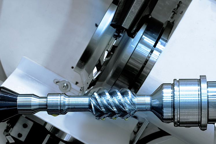

Work area of an EMAG profile milling machine with a milling tool. The machine is machining a rotor with a complex helical profile.
A view of the work area of an EMAG profile milling machine. A wide range of tool configurations is available, from disc cutters to solid carbide cutters. This enables the efficient and precision production of worms, rotary pistons, and rotors.
