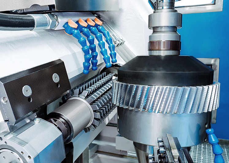

EMAG gear hobbing machine in gear manufacturing – high-productivity gear production for external gears
An EMAG gear hobbing machine machining a gear. The process enables high-productivity gear manufacturing with high repeatability. Ideal for gears, gear shafts, and worm gears in batch production.
