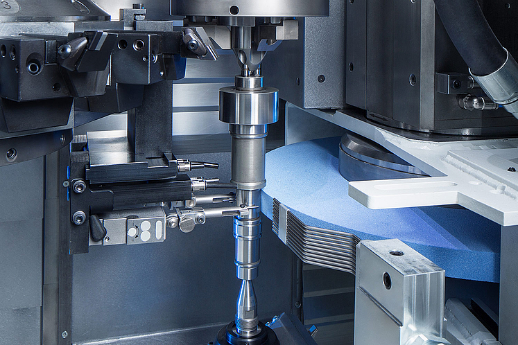

Work area of the EMAG VTC 100 GT during CNC grinding of shafts.
The VTC 100 GT combines CBN grinding, hard turning, and Scroll free turning in a single machine. All finishing processes are performed in a single setup, minimizing setup times. Unique flexibility in the finishing of shaft components.
