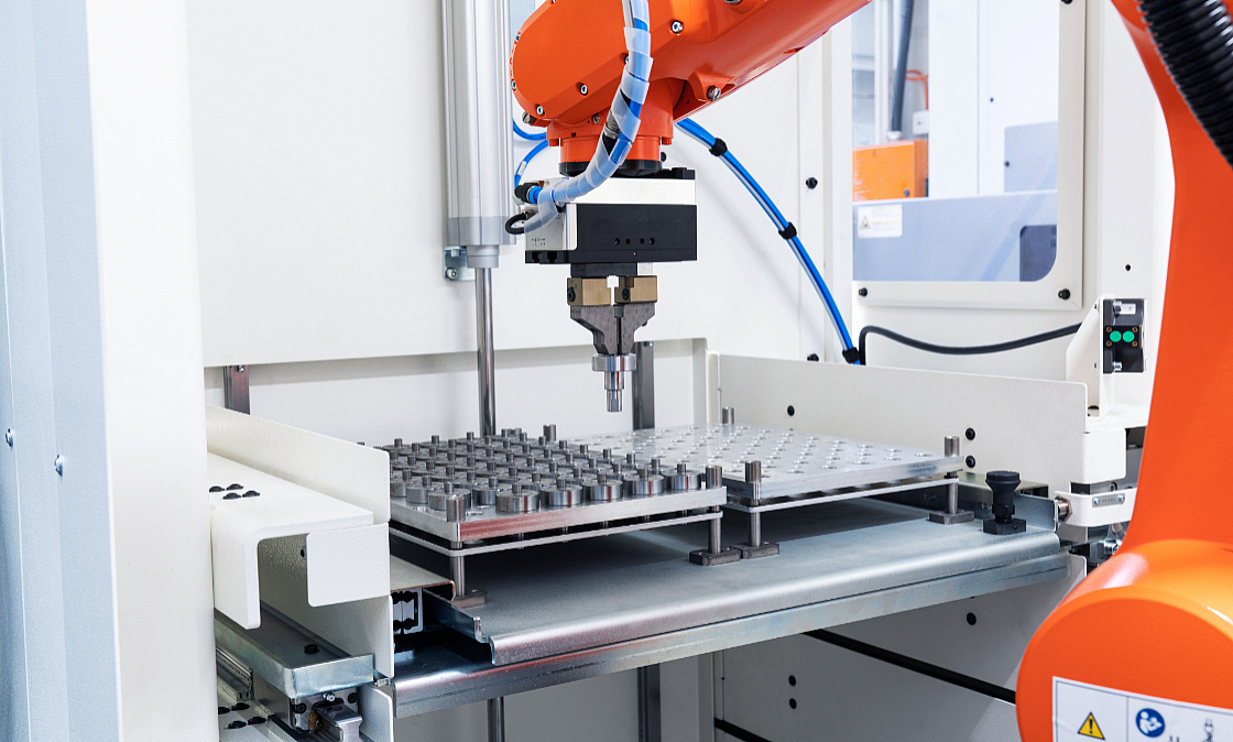

CRC Automation Cell with Basket Stacking
In automation cells with basket stacking, the loading and unloading of the system is done using baskets from which the robot grabs the pre-aligned workpieces or deposits them. The empty baskets are placed onto the stack by the robot.
CRC Automation Cell with Drawer System
With the drawer system, the workpieces are provided to the robot on different levels. While the drawers are being filled, the robot in the cell supplies workpieces to the machine.
