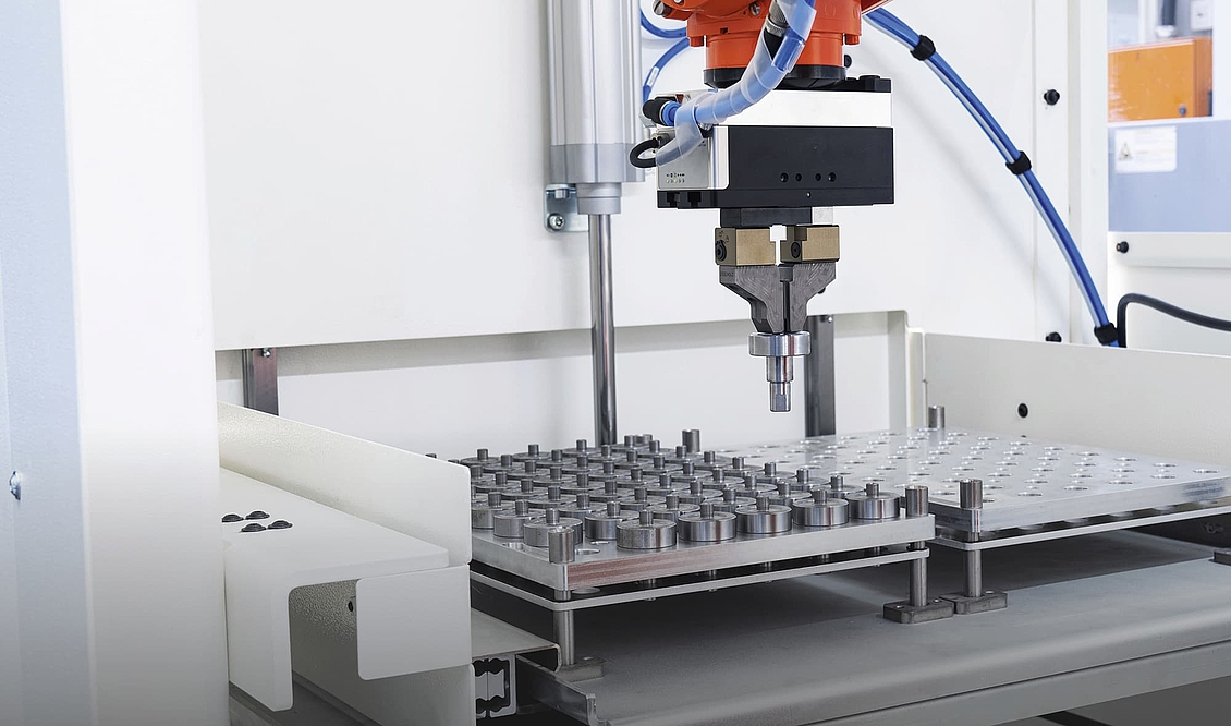

Another focal point at EMAG’s trade fair booth is the topic of automation, because the machine manufacturer from the south of Germany has developed new automation cells with robots. The entire production process is getting faster, more cost-efficient and more reliable, with the pick-up technology from EMAG being particularly suitable for this approach, as the machines have an internal automation system, which serves as a good basis for having them loaded and unloaded by robot solutions. The parts are, for example, fed in pre-aligned in baskets or drawers, chaotically as bulk cutoffs, or by means of infeed and outfeed conveyors.
