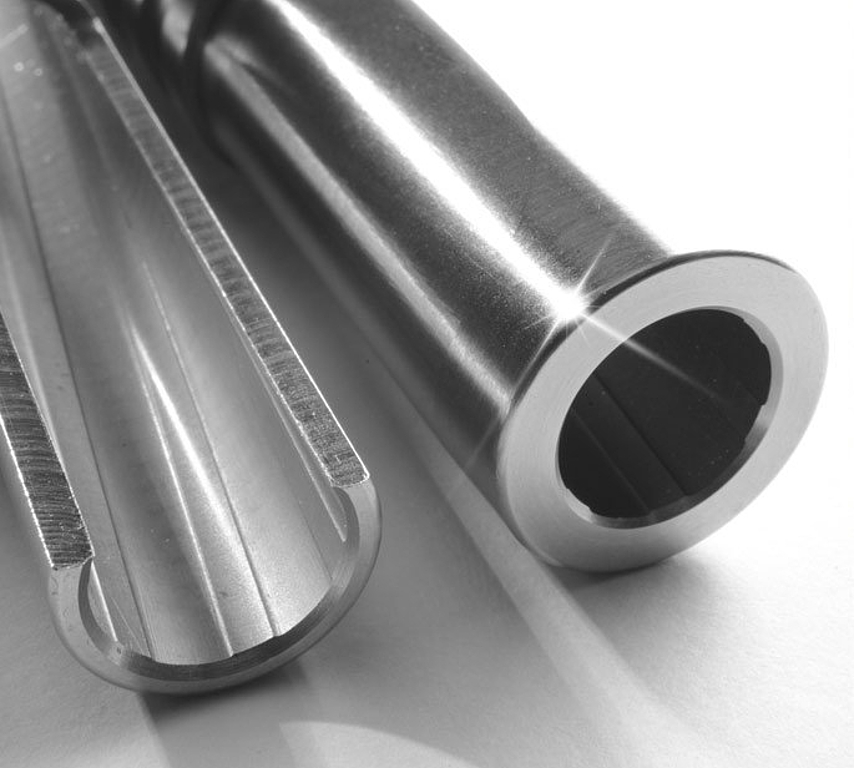

Gun barrels machined using ECM rifling. High-precision internal geometries achieved through the electrochemical rifling process.
Electrochemical machining creates high-precision internal geometries without tool wear. Ideal for cost-effective batch production in the defense industry.
ECM Rifling: High-precision barrel machining with up to eight-axis simultaneous machining
EMAG’s ECM rifling process uses electrochemical machining to create high-precision internal geometries in barrels—without subjecting the workpiece to mechanical stresses or thermal stress. With the modular PI machine concept, double or eight-fold modules can be used depending on production volume, allowing up to eight barrels to be machined simultaneously. The result: short cycle times, low capital investments, and virtually any internal geometry is possible - from standard rifling to polygonal and progressive. The process is suitable for both short and long barrels and offers clear process advantages over conventional hammering.
