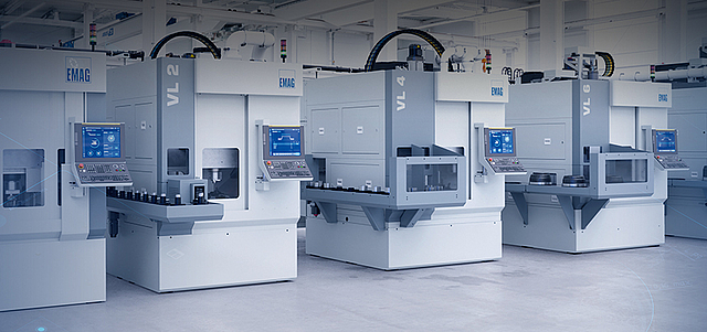

The 19" control panel with FANUC iHMI
Our 19'' control panel with FANUC iHMI was specially developed for the VL and VT vertical lathes and combines state-of-the-art technology with intuitive operation.
The advantages
1. Ergonomic design
The swivel-mounted 19'' multi-touch screen adapts to your needs. The flexible positioning enables comfortable operation and reduces fatigue during prolonged use. The large, interactive surface offers sufficient space for all important information at a glance.
Tiltable 19-inch, multi-touch control panel with large interactive surface, can be flexibly positioned for ergonomic operation on a machine tool
Flexible swivel-mounted, 19'' multi-touch control panel for optimum ergonomics and overview in machine control
