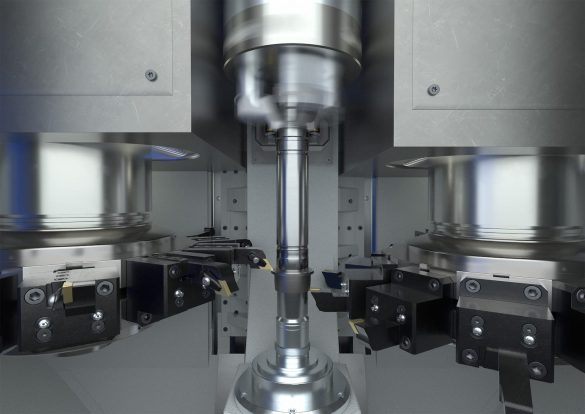

Rotor shaft OP 10 / OP 20
OP 10 / 20 – Green turning on two VTC 200. 4-axis machining of the shaft will reduce machining times significantly.

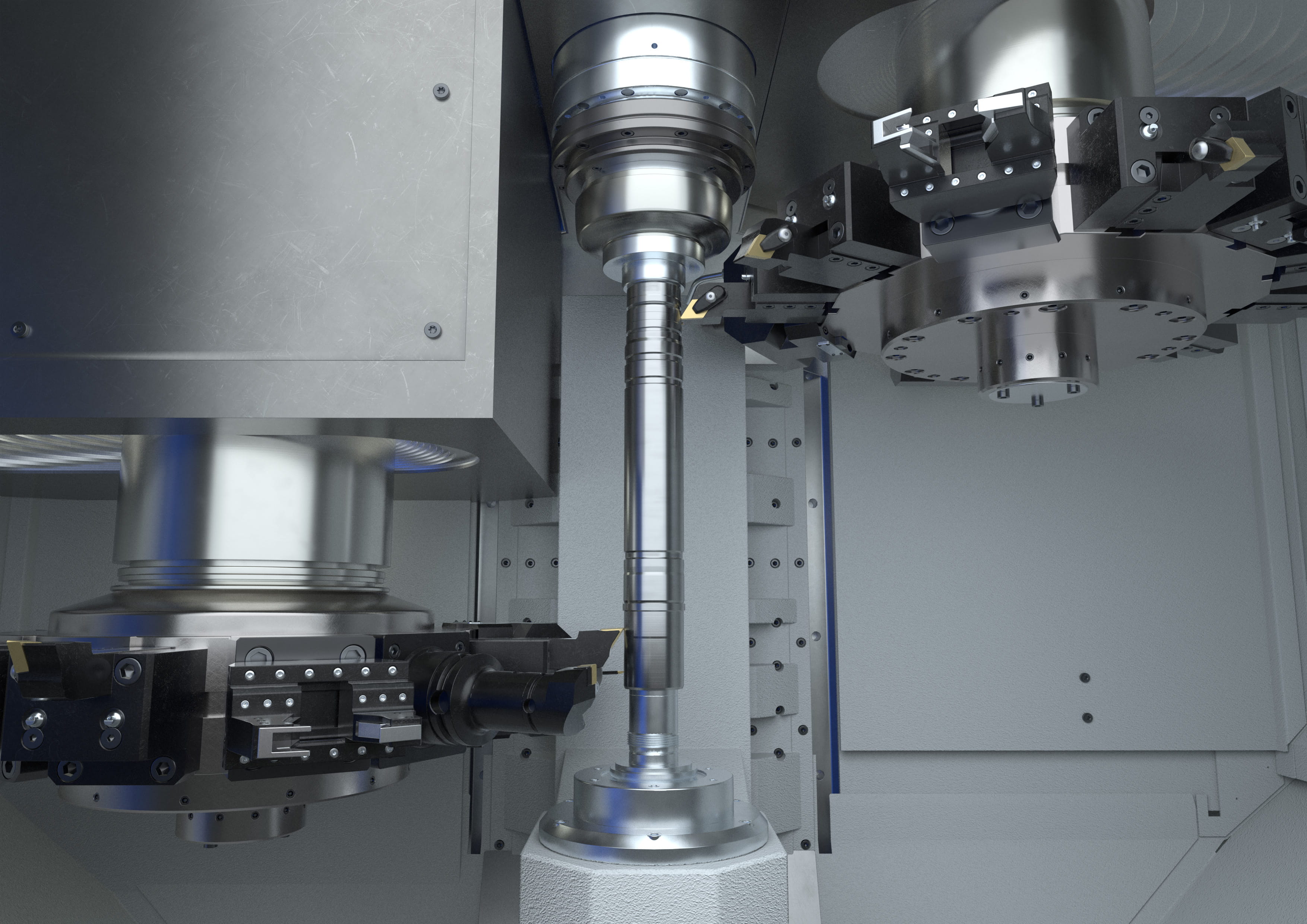

Rotor shaft OP 50
OP 50 - Internal turning of rotor shafts on a VTC 200 with center drive.
Rotor shaft OP 60
OP 60 - Fine turning and drilling operations with driven tools on a VTC 200.
