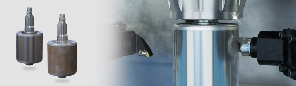

Scroll free turning is a turning process developed by EMAG in which a straight cutting edge, set at a 45-degree angle, sweeps tangentially past the rotating workpiece. The point of contact continuously moves along the cutting edge. This produces twist-free surfaces with grinding-quality finishes – significantly faster than with conventional finish-machining and completely dry.
Scroll free turning of seals and bearings, laminated cores with defined surface roughness, and cycle times more reminiscent of rough-machining than finishing: scroll free turning has established itself as a standard in shaft machining, particularly in the field of electric drives. Time for the five most important questions and answers about this technology.
Peeling tool machining a vertically clamped shaft in the work area of the EMAG VT 4
Scroll free turning in practice: In the work area of the EMAG VT 4, the scroll free turning tool machines a vertically clamped shaft.
