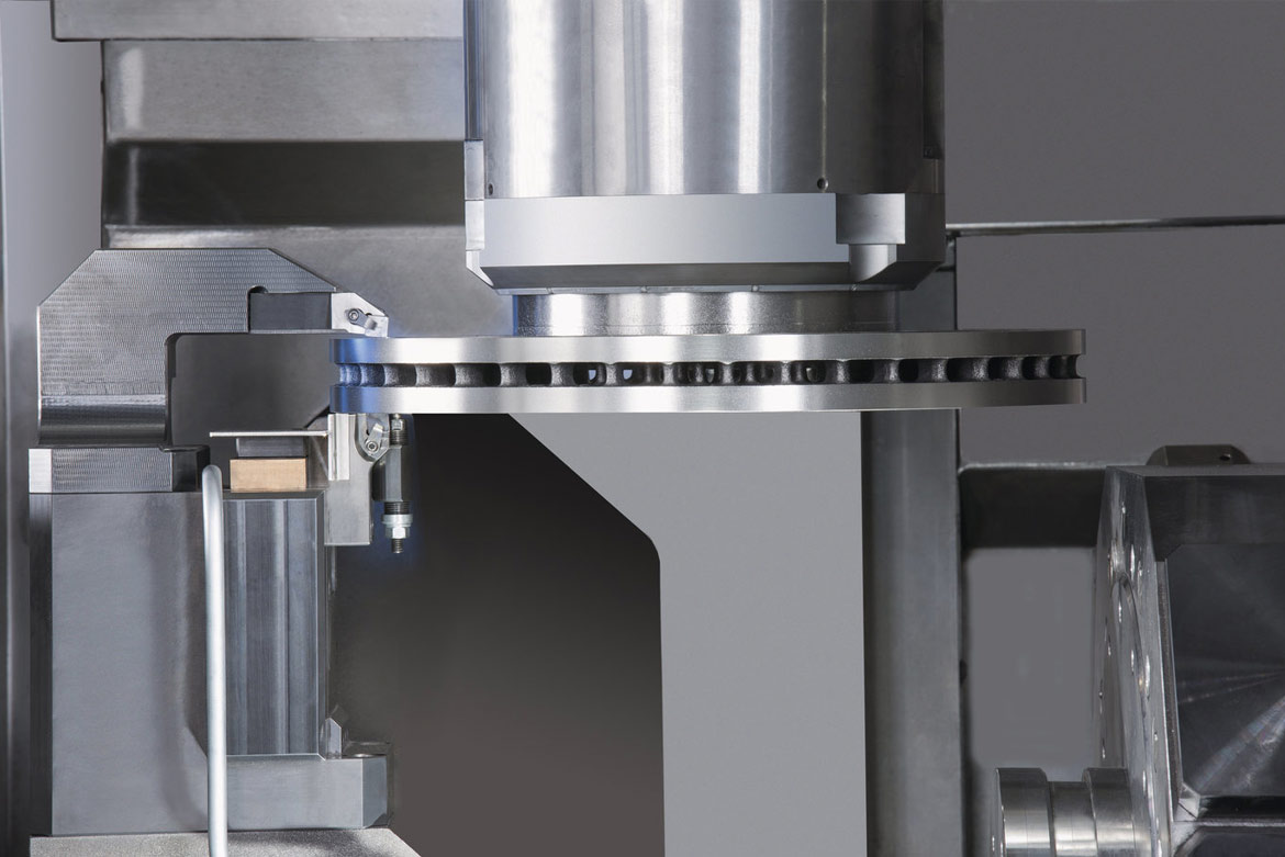

Our vertical pick-up turning machines are at the heart of brake disc machining. They ensure speed, precision and process reliability. In addition, the modular machines can be precisely configured for any requirement and very easily integrated into a production line. With the pick-up turning machines of the VSC series, EMAG offers manufacturing solutions that combine quality, productivity and process reliability in this field of application. Short cycle times are achieved by fast loading using a pick-up work spindle in conjunction with high linear feeds and the shortest possible turret swivel times. The machines also have a particularly vibration-damping machine base made of Mineralitâ. Powerful turrets with driven tools enable drilling and milling operations in addition to turning.
Pick-up vertical turning machines from EMAG for brake discs
Pick-up vertical turning machines from EMAG ensure speed, precision and process reliability in the machining of brake discs.
