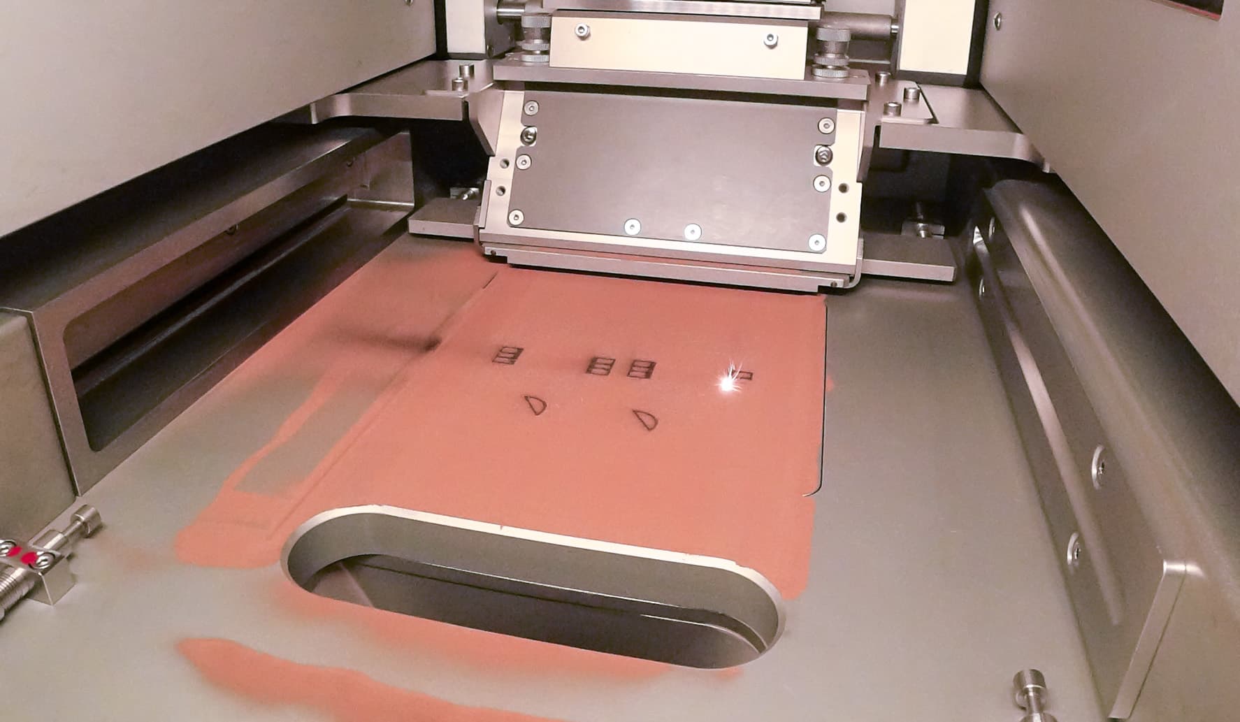

There are essentially two common processes for additively manufacturing inductors. These are Electron Beam Melting, EBM for short, and Selective Laser Melting, SLM for short. Because of its higher level of detail, the stability of the process and also the robustness of the method, we’re focusing on SLM. That is also the reason why the SLM method is gaining ground in inductor manufacturing. Nowadays, copper alloys are used with this method. While these have a somewhat lower electrical conductivity than pure copper, they are much stronger. According to present experience, inductors manufactured with SLM therefore have a much greater service life. Working pure copper currently is another major trend in the market. While it allows for maximum conductivity to be achieved, it leads to worse mechanical properties. Furthermore, pure copper requires a green laser, which is still very expensive. What the future holds in this respect is very thrilling. We are therefore closely monitoring these developments to obtain maximum quality from additive manufacturing for our inductors.

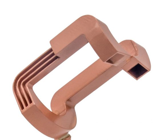

![Inductors—Additive Manufacturing Optimal coolant flow through additive manufacturing of inductors](https://www.emag.com/blog/en/wp-content/uploads/sites/2/2020/05/H739-585x491.jpg)
![SLM Process Additive manufacturing in inductor production](https://www.emag.com/blog/en/wp-content/uploads/sites/2/2020/05/SLM_Laser-585x341.jpg)

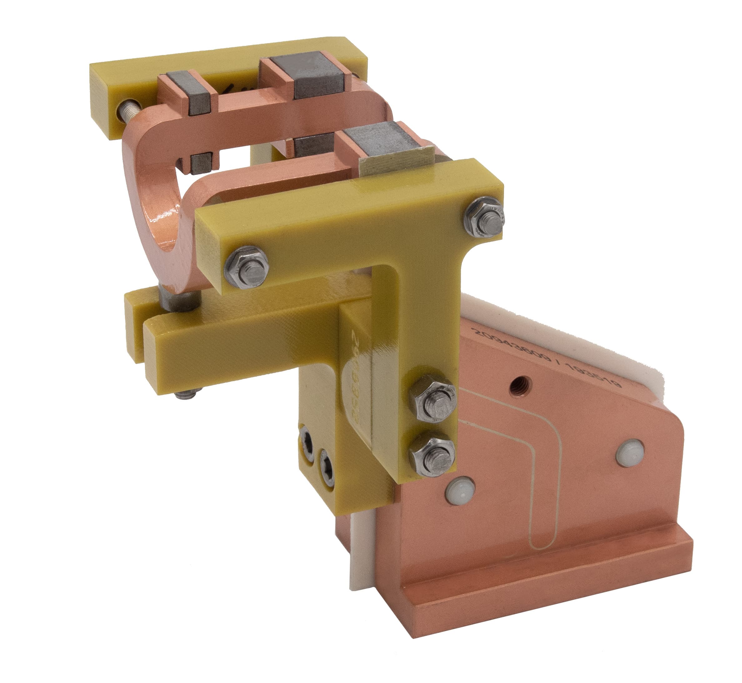

![Inductor Assembly Mounting the inductor winding onto the inductor base](https://www.emag.com/blog/en/wp-content/uploads/sites/2/2020/05/H736_Inductor-585x539.jpg)
Could you describe what such a manufacturing process involves?
It essentially all begins with the design of the inductors, which are first matched to the desired heating result for the respective component. The coil’s cooling is then optimized, which involves performing digital flow calculation to achieve a perfect coolant flow. This is where we make full use of the freedom in design that we gain from using the method. It has significantly contributed to how we were able to considerably increase the service life of additively manufactured inductors. Once this part of the design has been completed, we proceed with adapting it to the manufacturing technology. For instance, this includes correct alignment of the component in the machine’s installation space and creating the support structures required to manufacture the coils with SLM. The actual manufacturing process begins after this step and takes about 8 to 16 hours depending on size. Once the parts have been completed, the support structures are removed, and the coils are heat treated. This not only provides an improved surface, but also maximizes the material’s electrical conductivity. The coil must then be soldered onto the inductor base. However, before the inductors leave our company, a quality control inspection is performed using a 3D measuring arm in order to ensure dimensional accuracy. Once they have passed inspection, they are delivered with the corresponding measurement report and a special case. That is how we are also able to ensure dimensional accuracy during transport.
