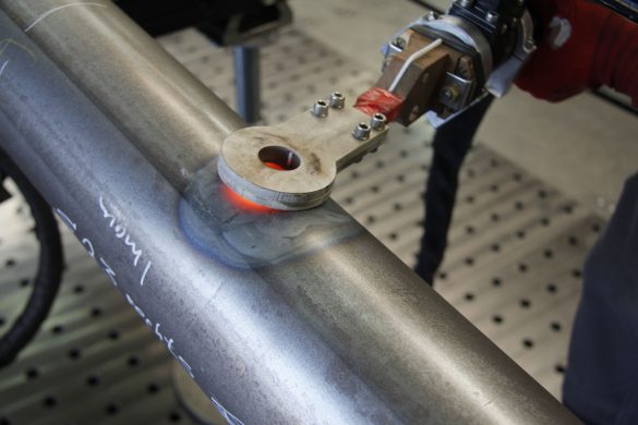

In the production of roller coaster rails, extreme precision is vital. The rails are up to around 12 meters long. Nevertheless, across all their twists and turns, they may not deviate more than 3 mm in the length or more than 2 mm in the track gauge. To safeguard this, we have a two-step process. After we bend the rails, we place them in a jig and measure them with a laser. Here, we can detect any non-conformance immediately and correct it with a special robotic clamping solution. First, though, this requires heating of the rails at defined points. In the past, we used a naked acetylene flame. However, that increased the risk involved in this work. Furthermore, the flame only applied the heat on the surface. This means that more force was needed to correct the pipe. Then induction heating caught our attention as an alternative. We already knew the process from another in-house solution.

We first tested an alternative induction technology and noticed that it was not easy to reliably implement the process for our specific application. To clarify, the operator must position a ring inductor by hand, maintaining contact with the rail pipe – and this has to be done at various positions. Even slight inattention causes the inductor to lose contact with the pipe. The first solution we tested resulted in overload damage to the generator. We then contacted EMAG eldec to develop a solution that is significantly more robust. Small operator errors cannot be permitted to cause machine failure.

We’re very satisfied. The solution, which includes a handheld ring inductor as well as a 15 kW PICO-SC generator with cooling system, has now been in use for around a year in our production. The process is very stable and it is no longer a problem if the ring inductor loses contact with the rail. All in all, we also benefit from a very fast and easy procedure. The operator starts the respective program via the touchpad interface of the generator and moves the inductor to the component. After a defined period, the desired temperature has been reached and the adjustment can start. Per heat spot, the induction technology is around 30 seconds faster than heating the rail with an acetylene flame.
