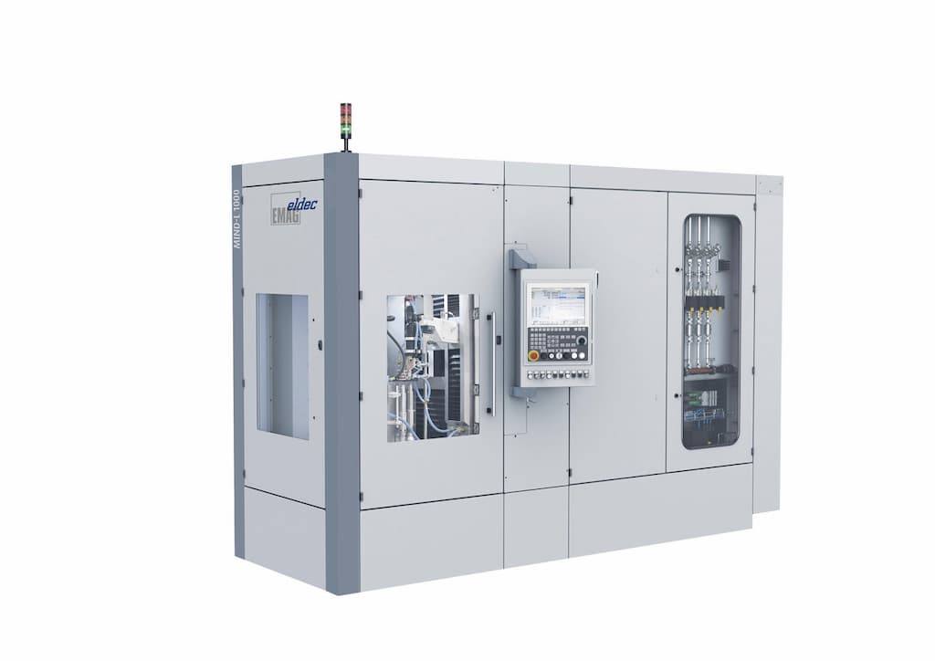

Yes, precisely, the MIND-L 1000. The machine replaces our tried and proven MIND-750/1500 series. We’ve overhauled the previous technology in every detail, and among others we’ve improved its ability to be integrated in EMAG production lines. For instance, an integrated gantry automation is available as an option for easy interlinking. Another important aspect is that the machine’s structural design has been fundamentally rethought—with a decisive effect: The price of the machine is lower than its predecessor without giving up on quality.
What’s more, we will also be showing our new eldec High Precision Tool System (HPTS). It is a multi-stage concept intended to improve component quality and repeatability. This, for example, includes our newly developed system for 3D printing of inductors, precision holders on hardening machines and a new measuring system for inductors.
![Hardening machine MIND-L 1000 MIND-L 1000 hardening machine from EMAG eldec](https://www.emag.com/blog/en/wp-content/uploads/sites/2/2019/08/MIND-L-1000-585x414.jpg)

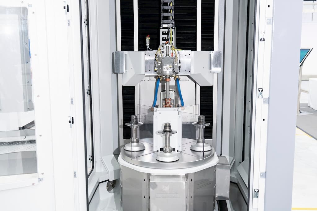

![Hardening machine MIND-L 1000 – Working area Hardening machine MIND-L 1000 - very good access to the working area.](https://www.emag.com/blog/en/wp-content/uploads/sites/2/2019/08/G990V0-585x390.jpg)

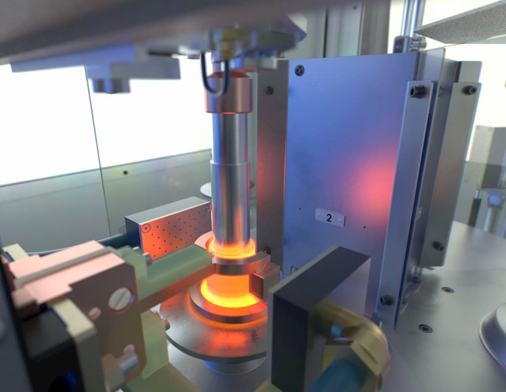

![Induction hardening with MIND-L 1000 Induction hardening with the MIND-L 1000 hardening machine from EMAG eldec](https://www.emag.com/blog/en/wp-content/uploads/sites/2/2019/08/201908H178V0-585x453.jpg)

Basically, everyone who wants to harden a great quantity of components as part of the line cycle. The machine is so flexible that it really can be implemented universally. Tools, coolant systems, clamping devices and energy sources, nearly everything can be configured and can be specified for a multitude of applications. If you want to harden a workpiece of up to 200 millimeters in diameter and with a maximum length of 800 millimeters, you should come and visit us at our booth.
