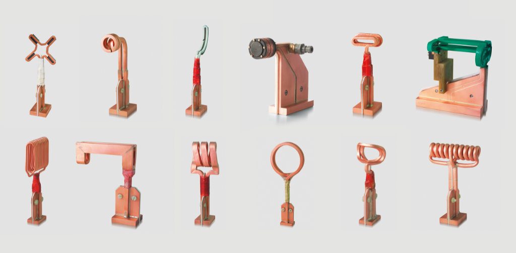

Wide variety of inductor shapes
Consequently, the inductors used are as many and varied as the corresponding parts or components. For example, eldec produces ring inductors and shaped inductors that enclose the part being heated with millimeter precision. Rod inductors sit inside the part during the process, heating the metal from the inside out. Flat inductors are also frequently used, for example, in induction brazing. They heat large areas of the part surface evenly and simultaneously.

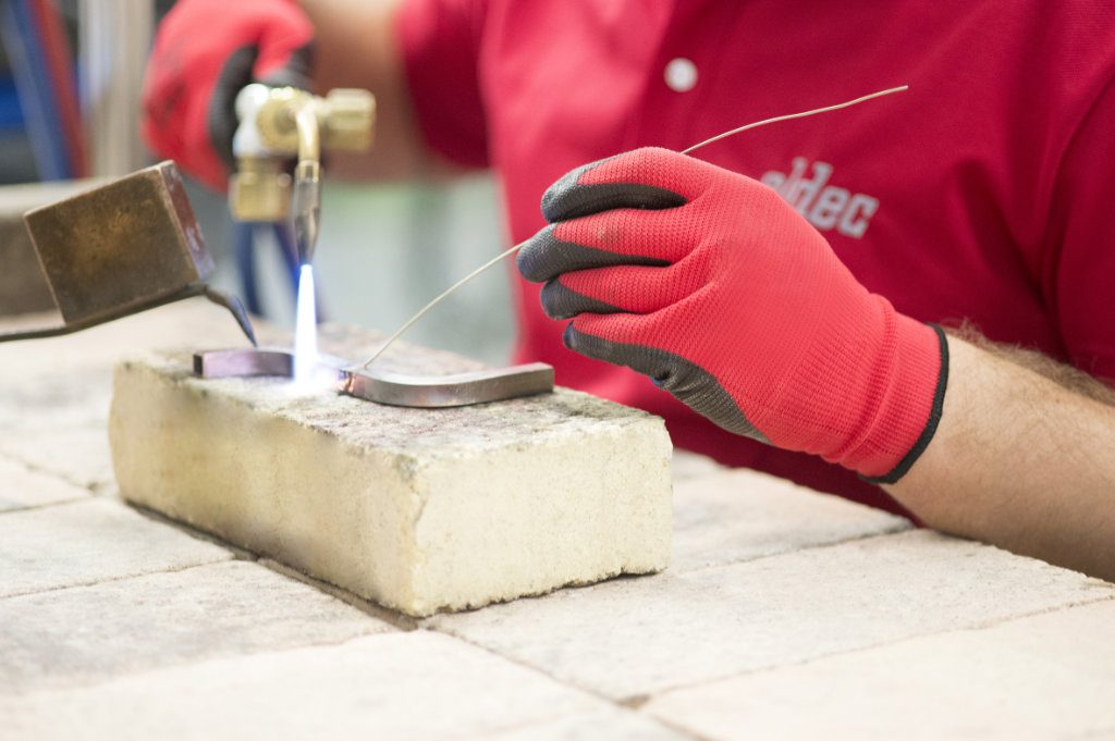

The EMAG subsidiary is now producing up to 1,000 inductors per year – and counting. The crucial quality that many customers put their trust in is the experience of our fitters and engineers. The complex manufacturing process for the inductor hinges on many minute details and cannot be automated. When brazing or assembling the inductor, every move has to be right.
![Inductor manufacture at eldec – complex manufacturing processes](https://www.emag.com/blog/en/wp-content/uploads/sites/2/2018/12/Induktorenbau-eldec-1024x681.jpg)
Inductor manufacture is a demanding process that cannot be automated.

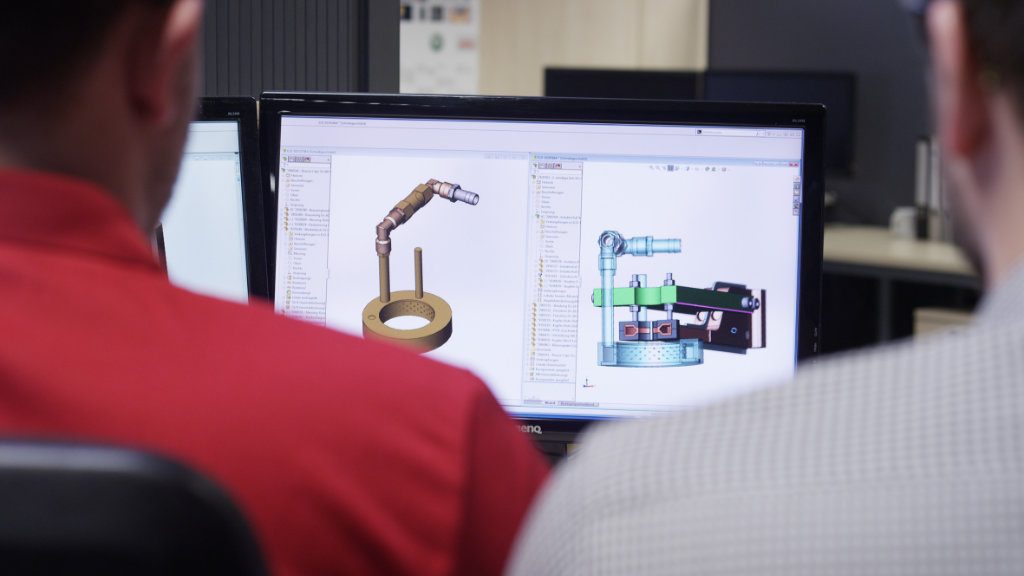

Once these questions are answered, the design of the inductor starts with the aid of the latest 3D CAD software and CNC machine tools. The final result is tested on the real part. If the quality of the manufactured part isn’t 100 percent satisfactory, we make changes and rework the inductor on a milling center. For highly complex inductors, such as those used for induction hardening, the required precision may be a matter of a few tenths of a millimeter.
![The inductor is custom-designed on a computer.](https://www.emag.com/blog/en/wp-content/uploads/sites/2/2018/12/Induktor-Konstruktion-1024x576.jpg)
CAD workstation at eldec: Inductors are custom-designed on a computer.

![The geometry of the inductors is as varied as the parts to be made with them.](https://www.emag.com/blog/en/wp-content/uploads/sites/2/2018/12/Komplexe-Induktor-Geometrien-1024x502.jpg)
The geometry of the inductors is as varied as the parts to be made with them. Ring or shaped inductors enclose the heated part with millimeter precision.
