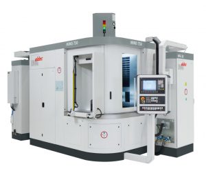

Electric motor producers should consider holistic MIND hardening machines. Through the precise selection of power and frequency, the holistic system guarantees a hardness pattern in accordance with customer requirements (e.g. for gears or rotor shafts). The induction heating takes place in the desired hardening area and takes only two to three seconds for a gear or 1.3 seconds for a rotor shaft.
MIND hardening machines are configured modularly for the workpiece dimensions and desired hardness pattern. The system is, therefore, available as a manually loaded standalone solution or as a line-capable hardening cell that is loaded by a robot or gantry.
Induction hardening processes in electric motor production with an eldec hardening machine
MIND systems integrate comprehensive hardening processes in one machine, e.g. simultaneous hardening of several areas of a workpiece, annealing processes, geometry and workpiece inspection, and many more.

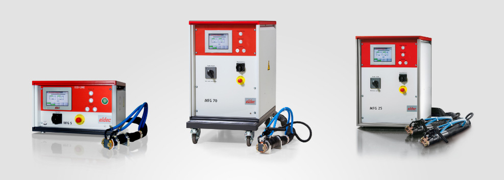

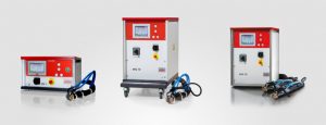

The 30 kW ECO LINE generator can also be used to heat the entire stator to 110 to 130 °C before impregnating the winding. Induction pre-heating for welding – such as for rotor shafts – is similarly important for many production processes. It is an effective way to prevent cracks in the parts at the high welding temperatures.
Generators from eldec for induction heating
ECO LINE – the middle class: Energy sources as a standalone solution or for integration into systems (MF and HF 5 – 150 kW).
