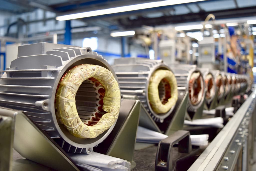

It is used to manufacture the electric motors that drive our fans and side channel compressors. Specifically, the goal here is, as we say, to “marry” the empty stator housing and the motor winding. To achieve this, the housing is first heated to a temperature of 280 to 300 degrees Celsius. This causes it to expand and allows for the motor winding to be inserted. Once they have cooled down, both components establish a form-fitting and solid bond. This joining process has existed for a long time in our production. However, the former induction heating system was in need of improvement. Among the issues was that it did not indicate the component’s actual temperature after heating. This then led to extended throughput times when joining the empty stator housing and the motor winding. One of our main goals, therefore, was to improve this process and make it more reliable.
