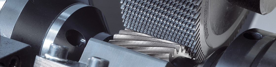

Gear Shaving – Low-Noise Surface
During the process on the EMAG SU machine, the workpiece and the shaving cutter form a gear pair with axes that are rotated relative to each other (axis cross angle). This positioning results in sliding between the shaving cutter flank and the workpiece tooth flank. It is also important that the tooth flanks of the shaving cutter have small grooves that act as cutting edges. And because the process takes place before the hardening process, any hardening distortions are processed by the shaving cutter.
