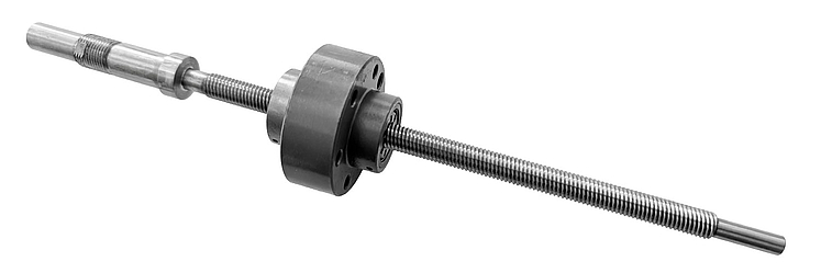

The screw shaft for humanoid robots is characterized by a compact design with the highest precision requirements. The starting material is a hardened steel blank with a hardness of HRC 60, which must be ground after heat treatment. The total length of the spindle is typically 110 to 120 mm, where several graduated O/D (Outer Diameter) must be precision ground.
Planetary roller screw consists of a precision-ground screw shaft and the corresponding nut.
Planetary roller screw drive with shaft/spindle and nut for precision conversion of turning into linear motion.

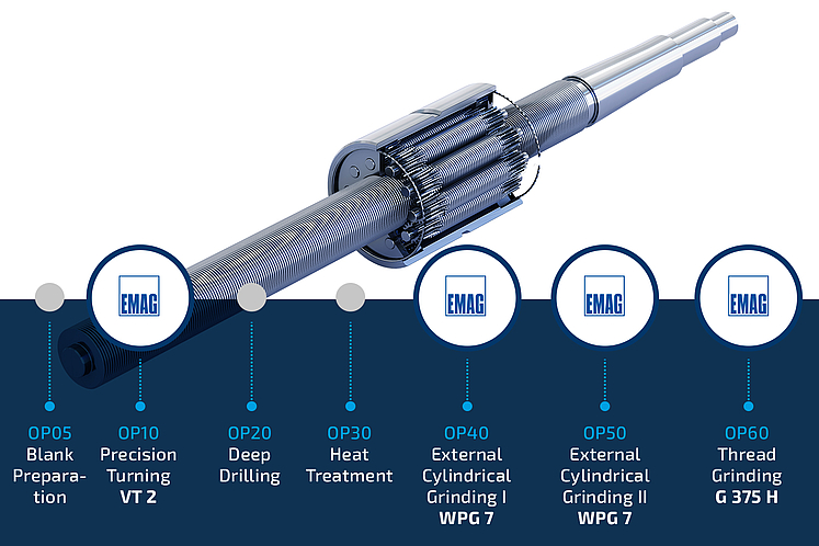

The Complete Process Chain: From Raw-Parts to Finish Machining
Manufacturing screw shafts for planetary roller screws requires a carefully coordinated process chain that includes several steps from the raw-parts to the finished machined component. EMAG offers optimized solutions for this process chain.
  1.  OP05 - Blank Preparation: The starting material is a steel blank in cylindrical form that has already been pre-machined to the approximate final dimensions.
  2. OP10 - Precision Turning (VT 2): Pre-machining of the contours is carried out on an EMAG vertical turning machine from the VT series. All diameter increments and end faces are prepared with defined allowances for subsequent grinding.
  3. OP20 - Deep Drilling: The central bore of the spindle is drilled using a deep drilling process. This bore is essential for weight reduction and serves in part as a guide for subsequent machining steps.
  4. OP30 - Heat Treatment: Hardening to HRC 60 ensures that the spindle can withstand the high mechanical stresses in subsequent use. After heat treatment, finish grinding is essential.
  5. OP40 - External Cylindrical Grinding I (WPG 7): First grinding operation for machining the thinner shaft sections.
  6. OP50 - External Cylindrical Grinding II (WPG 7): Second grinding operation for machining the larger diameters.
  7. OP60 - Thread Grinding (G375H): Final machining of the precision thread on an EMAG G 375 H thread grinding machine.
Graphic process chain for the machining of screw shafts
The graphic shows the process chain of a screw shaft - from raw-parts to fine machining, deep-hole drilling and heat treatment through to two-stage external cylindrical grinding and final thread grinding.

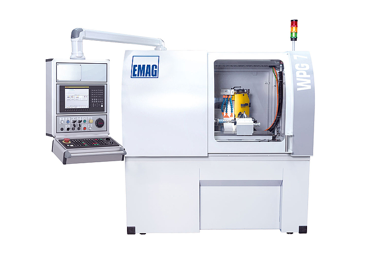

Machining Strategy with two WPG 7 Cylindrical Grinding Machines
The challenge in grinding screw shafts is the combination of small diameters, hollow shaft characteristics, and the tightest tolerance requirements. EMAG therefore relies on a two-stage machining strategy with two WPG 7 external cylindrical grinding machines, which is optimally matched to the specific requirements of the component.
Front view of the WPG 7 external cylindrical grinding machine
WPG 7 grinding machine for external cylindrical grinding of precision shafts.

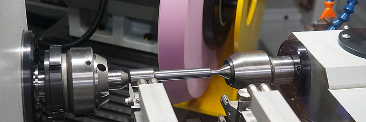

OP10: First Grinding Operation - Machining the Thin Shaft Ends
In the first grinding operation, the thin end of the spindle is machined. This area places special demands on the process control due to the low wall thickness (the spindle is hollow). Even low grinding forces can lead to vibrations if the support is inadequate, which can impair both the surface quality and the dimensional accuracy.
OP20: Second Grinding Operation - Machining the Main Diameters
After turning the workpiece, the second grinding operation involves machining the larger diameters. As precision reference surfaces have already been created in OP10, it is now possible to work with a rigid steady rest that is supported on the previously ground surfaces.
Work area of the WPG 7 with clamped screw shaft and grinding wheel for external cylindrical grinding.
The work area of the WPG 7 shows the setup of a screw shaft during external cylindrical grinding.
